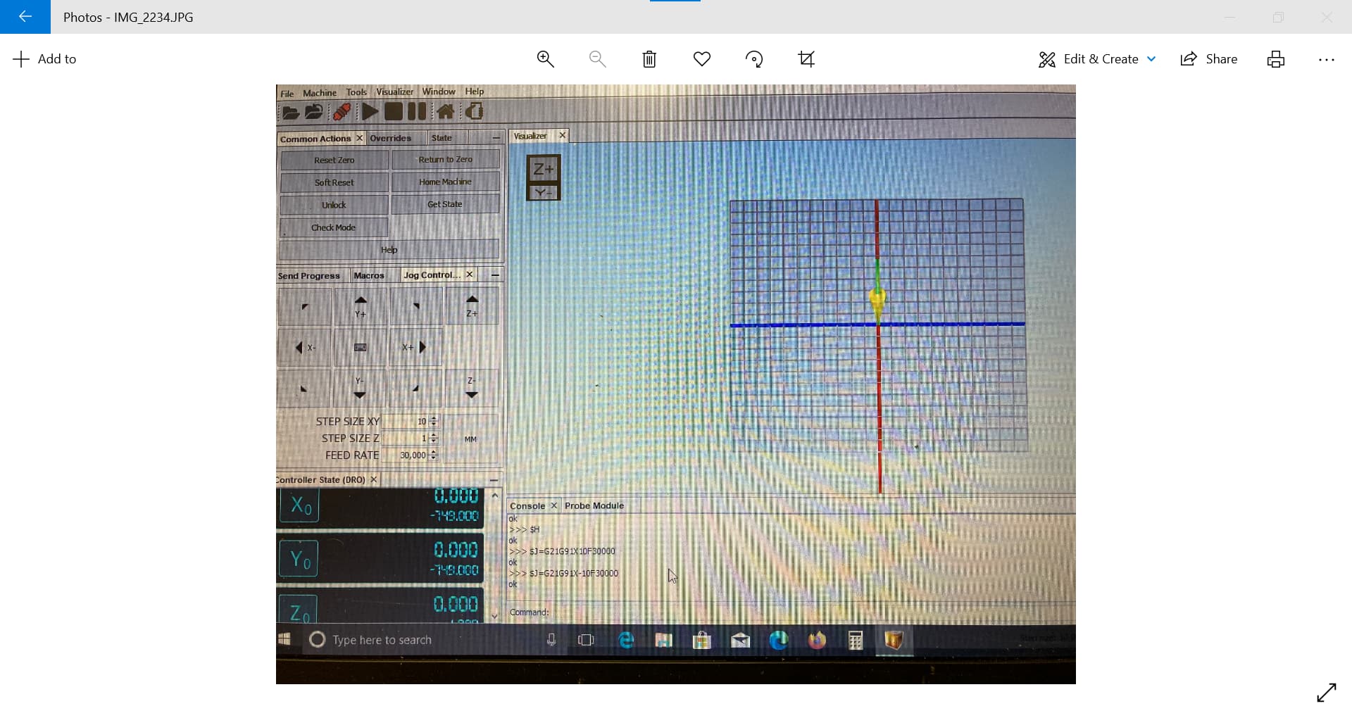

Hi again Neil / [SethCNC] /( [BrandonR_Parker] managed up to the workshop just for a wee bit today , It looks like the table size has changed , router moving the correct directions but showing as negative numbers eg …Apologies on photo quality :grimacing:
Pic showing spindle when homed !
& after moving one click in the correct directions …
If I remember correctly on setting up the x-carve / ugs I had to reverse the z axis !
Everything is moving in the correct direction when jogging . there are a few funny looking $ codes , but I cant find an actual copy of what grbls 1.1g should look like ( it is a 1mx1m table sized x-carve ! here is what Ive got just now
Im wondering if I need to delete ugs completely & totally reinstall everything , If I do would I need to go right back to the start eg through easel etc ? It will be a bit of a pain due to lack of internet but if thats what it needs Ill just need to , I could probably just rewrite all the grbls manually ? if I could get a note of what they are supposed to be !
Would I be right in saying while jogging from homing/ zero …numbers should be positive in X & Y and negative in Z ?
Thanks again for the help !
If the router is moving correctly, you’re good. The negative numbers are your MACHINE position, and you shouldn’t need to worry about those. That just provides an absolute reference for your WORK position which are represented by the larger numbers in the digital readout.
Grbl defines, by default, the MACHINE zero as back right with the Z up. Everything in your usable space is in negative MACHINE space. Again, the WORK zero is what matters.
