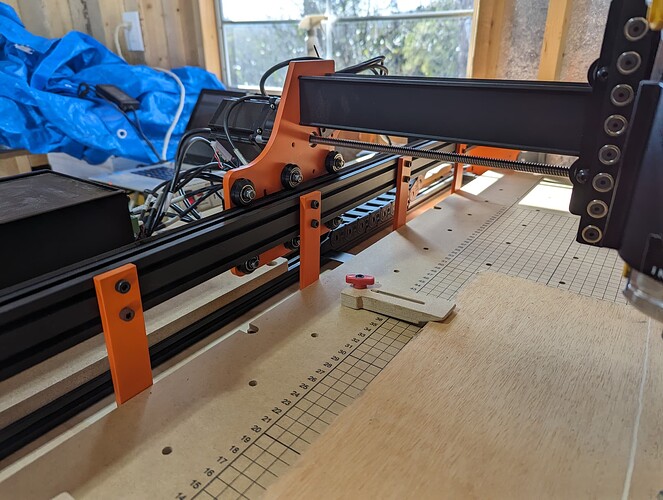

As quick as I can describe my issues.
I bought the original X-Carve and updated in early 2019 to Lukes kit TBDcnc Direct Drive Z axis and screw drive with the stiffeners etc. I installed everything withe upgrades stepper motors as well.

For one my Z is moving in the opposite directions… Down is going up and Up going down.
It’s moves left and right correctly.

Here are the photos.

First I’d correct your settings for the steps per mm. I’ll link a method I’ve shared.
Calibrating my X-carve 1000 - X-Carve - Inventables Community Forum
If your Z axis is going up instead of down, there is a number in $$ that needs to be changed. It is $3=4. You can see the chart here.

Hmm, so I did change the from $3=3 to $3=4 and it did in fact reverse the X&Y.
I did some calibrating and when I input the new #'s. It slammed the Y all the way forward. Luckily the homing switch survived.

Lastly $100 and $101 can be computed as I mentioned in my above link. You measure what you have and do the math ratio for what you want. Multiply the resulting number by the current number and that new number should be the replacement.
It appears you have lead screws, so the default X carve numbers for 100 and 101 won’t work. You can easily jog a distance, say 100 mmm, and see what the actual measurement is, and do the math.

Tyvm! Very good. I will try that. My Z, X and Y all jogging in correct direction now with the $3=3 . Is there a need to change it to the $3=4 now?

If $3 is working…don’t change it.

Cut a 2 x 2 square and measured it after the cut.
Measures 2 1/8 on X and a smidge away from 2" on Y

So ran calibration again and input the new #'s. Was happy too see 204 and 201 that’s for sure! But now it’s jogging to the left a bit and when finished please see attached photos. It’s off of my starting work piece X only by 1"
If you home the machine, then jog to your starting point and reset the zeros. There is machine zero and work zero.
Check across the Y makerslide from back left to right front and from back right to left front with a tape measure ( kind of like making an X). If the machine is square, the measurements should be the same. If not, adjust them. Also When you home the machine, check to see if the X axis is square to the machine. The X axis can flex a bit, but when the motors are on you can’t adjust it. Some folks put a piece of wood in front of the machine and adjust it before they turn on the motors.
