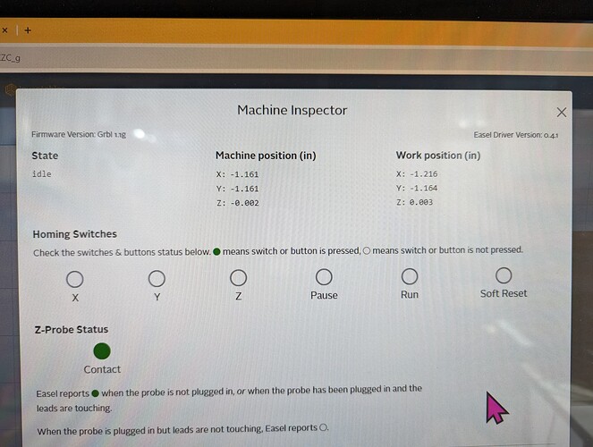

Also after I “Home Machine” these are the #'s that are in Machine Inspector. Shouldn’t they be at “0, 0, 0”?
All my homing switches work. Everything you sent me I followed just now. I also put the spindle into the center while running and shut it off a few seconds and turned it back on and homed it.
Every time I try and run a carve and after it’s finished and returns home, it’s literally off 2CM (20MM) or two squares on the spoiler board.

Did you happen to see this post? My machine and work position is in the negative. How do I get it to 0,0,0?
Have you checked to see if this is the problem?
pull off
This is the point where your starting machine position would be.
The way some X controllers were made, they give you negative numbers after homing. The reason being milling machines ( so I’ve read) had homing in the back of the machine from what the X carve looks like.
Do you reset all the zeros after homing?

Also note that Machine position isn’t work position. You can make work Zero where you want it to be.

The numbers being negative are or no real consequence to the user. This is all in how the homing switches are configured on a machine with respect to where the working space actually is.

What @MartinW.Mcclary is showing just above in Easel with the red arrow simply gives the user the ability to see where the coordinates are for each corner and the center as well as position the object/objects using each of these locations by inputting values when each is selected.
In Easel, the user does not “set zeros”…
The user homes the machine and this is what sets the machine (0, 0, 0) point; that is the exact purpose of having homing limit switches.
Prior to carving, Easel walks the user through setting the bit where the “Work Home” is based on their project. When the user goes through the items and either uses the last home position or sets a new home position, Easel command grbl to mark this machine position as the “Work Home” position which is, in reality in the firmware, just offsets from the “Machine Home” position.
When a project is sent to the grbl firmware, the gcode is created based on the file. You can choose “Left Front Corner” or “Center” for the (0, 0, 0) “Work Home”. Typically, people start with the first which is the default. I would start with default.
The project’s gcode creates machine movements to fulfill the milling of the design as movements with respect to “Work Home” and the movements are just offsets from what the grbl firmware has saved for the “Work Home” position.
