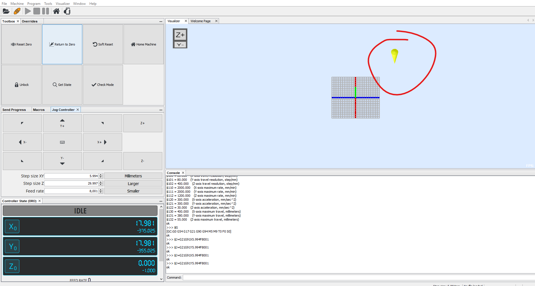

Ah ok , that would explain that ! as I am front left Z up :+1: How would I change the table dimensions on the visualiser ? the grbl settings seem about right with $130= 750 $131=750 & $132=100 I am sure if showed the full sized table & spindle bott left even before a file was loaded , but I may be mistaken there ! Just wonder if that would have any bearing on the carve triggering the far left soft limits ? eg should that still be ok even though it is actually negative 750 750 &100 max travel? my home & return to zero are both set to bott left !

You don’t have soft limits ($20) enabled.
I don’t think that grid represents anything until you load a file. I haven’t used UGS in a few years. If your $130s are set correctly, you should be fine. Without soft limits enabled, you could drive the machine left and crash for days if you want.
Cheers again Neil … Ill change a couple of things tomorrow $3-7 change to $3=3 , $20=0 change to $20=1 Im happy enough with $130s but ill probably do a calibration when Im there ! Still not sure why the carve was all over the shop , I wouldnt have thought these settings should alter anything really …unless $3 might be the problem ! I did notice in seths post for easels default $21 = 0 mine is $21=1 …hard limits .
$3 is the directions for movement, so if whatever yours is set to works correctly, then I would leave that how it is, or else stuff will be driving in the wrong directions again. Re:$21 and $20, yes you’ll want to change those to the defaults. Also $130 and $131 set to 790 will give you the real max work area, so I’d change yours to that number too…
Regarding your photos of the grid size in UGS, the reference size prior to loading a file is really just there for reference it’s actually irrelevant in reality and does not limit where you can drive the spindle too, what you see there for a grid is not your limits, it’s just a guide for homing and setting work zero.
Load your file and the grid will expand per the file requirements.
It will allow you to drive outside the grid without any errors as seen here :slight_smile:
Regarding showing Negatives, this i becuse you have not clicked the “reset zero” button, you will need to position the spindle to whereever your datum is set to 0,0 and then click that reset zero button (typically the front left top in Easel, but can vary depending on how you choose to design…)

I think he’s set his zero. The negatives are all MACHINE coordinates. Your screenshots show those negatives as well.
I don’t use UGS, but isn’t this what it looks like when you Zero at the front left of the X-Carve, assuming a 1mm pulloff on homing?

Oh yes, you’re right the spindle also will not appear until set zero is hit… so your definitely correct, he must have zeroed… I did a quick test (i haven’t used UGS in about 2 years) and the negative numbers are the prozimity to hitting the soft limits. If that negative number hits 0 then it has reached the X Right or the Y Top, Or Z top soft limit.
& Yes, exactly right about the 1mm pull off effect
