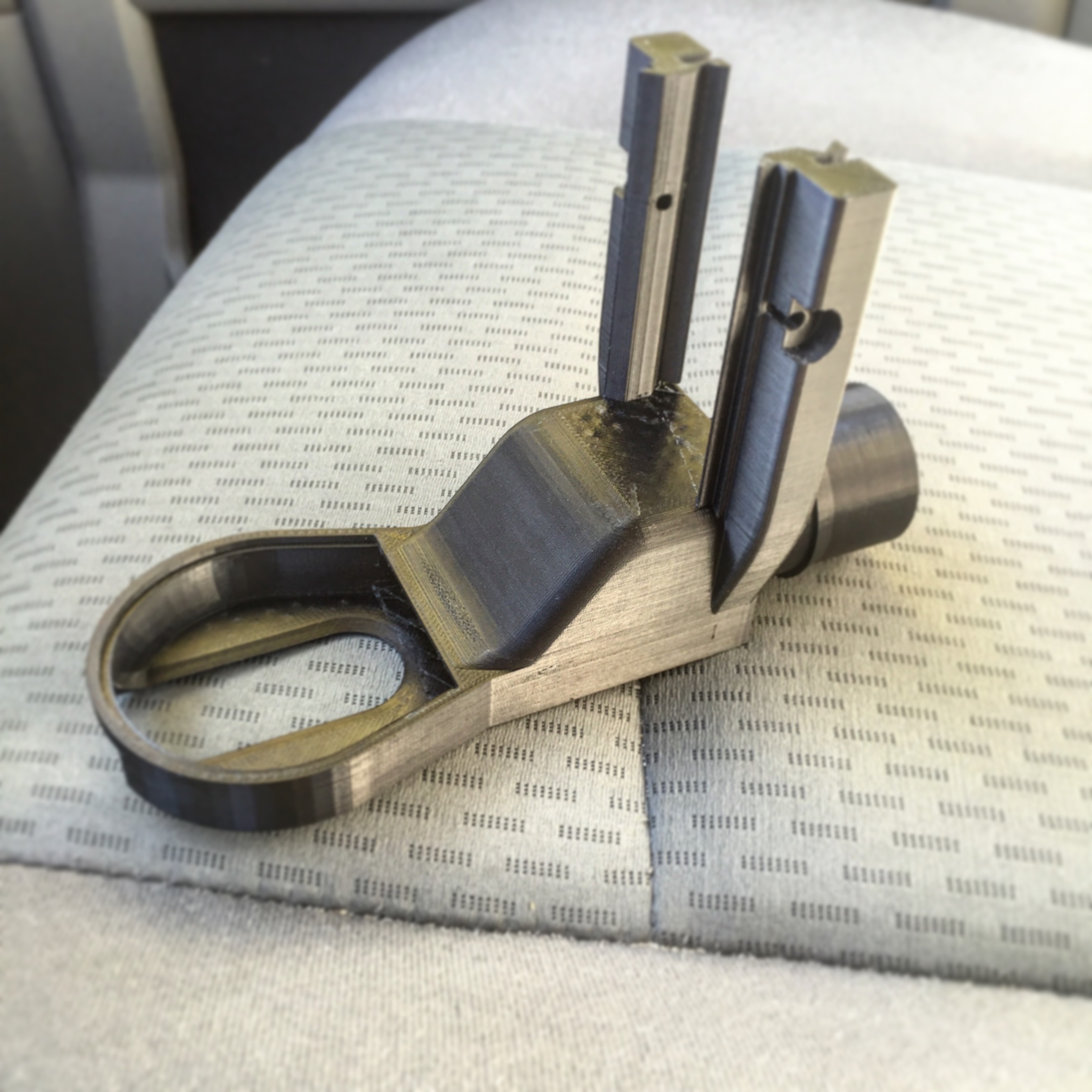

OK I’m getting ready to upgrade to the 611 and figured I would come back to this design. Here is a question. Can I just slide the dust shoe onto the mount and allow it to move up and down freely dependent on the thickness of material or does it absolutely have to get screwed in and tightened?
I don’t know why but I feel like this design would work really well if it just “floated” on top of the material and moved up and down for materials of different thickness. Figured I’d ask before I wasted time printing it.

My print just came in. Looks great. Can’t wait to get it on the machine.
Just noticed that it came in with the tabs still. Mine was made with these as well. You can see the triangles that are on the back part of the extrusion T filler. The part that slides into the maker slide from the bottom. I used an utility knife to score the line. About twenty light passes and the triangle snapped right off, clean and clear. If it doesn’t come off completely clean, a little sandpaper or a file can smooth out the edge so that it smoothly slides into the T-channels on the maker slide.
Happy X-Carving!!!
Yes they are overhang support during printing. I usually build my own support than rely on the slicer. For me I just snap them after printing, no sanding or pre cutting mark.
Looks like you print it on the different orientation cause I see some mark of support inside. If you follow the right orientation for printing, you wont need to turn on support on the slicer and you will have clean print.

@ErikJenkins Looking at your picture does your dewalt 611 have some sort of air diverter on the bottom of it? If so, how did you make/attach it? I have my dust shoe in place and its getting about 75% of the dust, but the down draft from my 611 still blows a ton of dust all over.
My picture? No I don’t have a diverted on mine.
I think he’s talking about the pic on post 83 to this thread
@NathanHorsley @sketch42
I see, yes I had the diverter on at that time, I no longer use it, I am not using that dust attachment either. It worked fine for some pieces, but I find myself using thicker material and that attachment would not work, I did not have enough clearance, and since I have to take off the spindle mount to put it on, I decided it was not worth it.
@sketch42
Thank you for clearing that up.
@ErikJenkins
What are you using now, may I ask? I get too much dust to go without, and was rather disappointed at the loss of depth myself. The dust shoe works really well for what i’m cutting now, but I had ideas of larger stock to carve eventually.
Right now I am chasing around the spindle with a shopvac, but I will be making the one posted by @AlanDavis this weekend.
