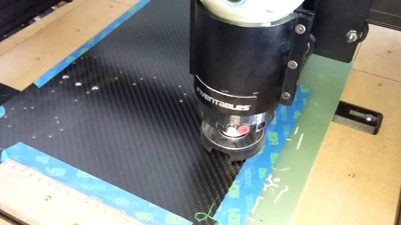

I designed previously a fixed dust extractor on my Shapeoko 2 and it works very well on most of my projects. Almost no dust escape even setting the vacuum to the lowest suction.
So when I pre-ordered my X-Carve I started to design similar approach. This one is supposed to be much better and more rigid interms of mouting.
Last week I got my xcarve and finished the assembly process, made some final adjustment to my design and printi it.
But unfortunately I didn’t like the 24V spindle. Can’t spin more than 14k rpm which is not enough to cut G10 and CF compare to my Shapeoko 2 with Makita Compact Router. Guess I’m gonna return this 24V spindle and order the 611 mounting and re-adjust the measurement for the dust shoe.
Here’s my old Shapeko 2 with fixed dust shoe and makita router.

The printing structure is very rigid and strong. Printed on ABS. I dont think I can break this thing on normal use.
Here’s the final version. Bottom hole are more wider for more airflow.
The way to install this is loosen 4 screws that hold the Z axis and then slide it to the z makerslide from the bottom. Then install back the 4 screws but before tightening perform angle calibration as instructed on the xcarvem build guide.
This shoe can be adjusted up to 1 3/4 and lock on place with tow m3x12mm screw.
I finally start cutting all my mini quad frames orders. I had lot of pending because I decomissioned my Shapeoko 2 and spend some time finishing the X Carve. I never cut carbon fiber without dust extractor.
So far so good. I’m on my 3rd sheets now. I’ve been cutting 6mm and 1.5mm carbon fiber.
