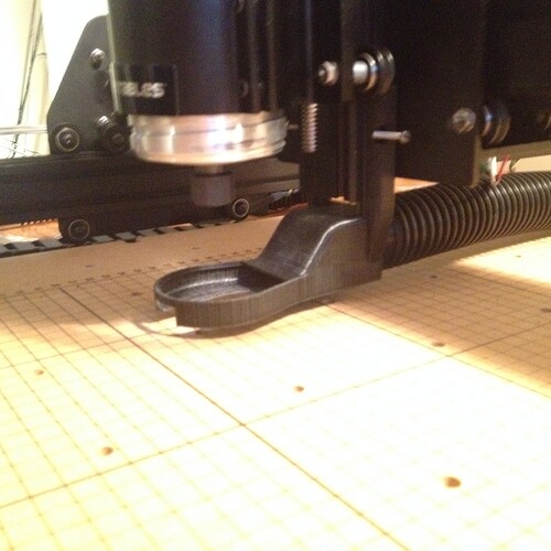

My X-Carve is ordered and on the way. I decided to go with the Dewalt 611, and I’m going to be printing this fixture to use with it.

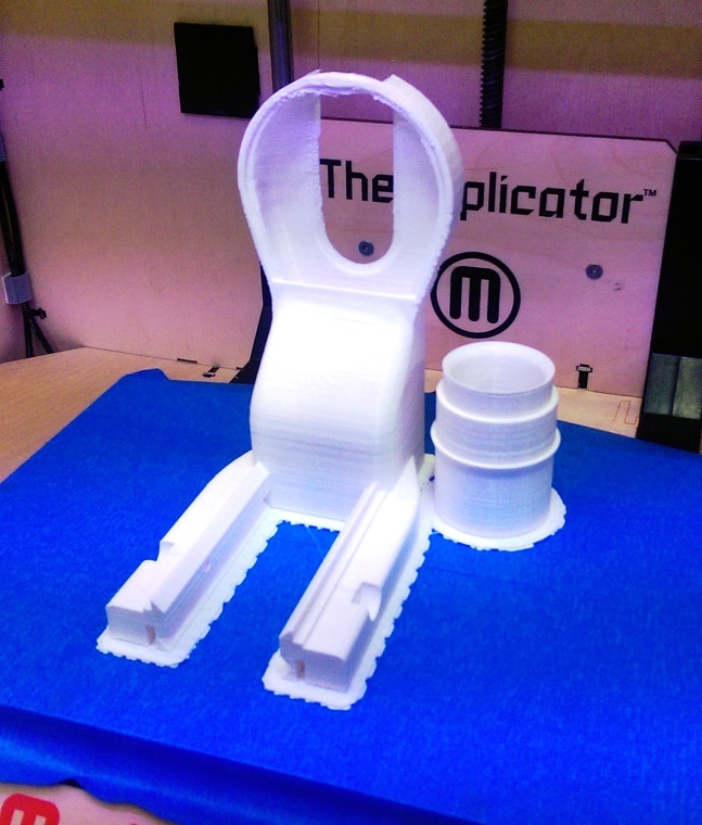

Printed mine (white PLA… got kind of melty and boogered up the top/nose, but that’s okay)… can’t wait to get my X-Carve and Dewalt 611 to put it to use. ![]()
But it’s WHITE.
. Looking perfect.
I had this printed out but it won’t fix in the makerslide. I had it done in PLA with high resolution. Anybody else have this problem?
Hi Paul, I’m going to start with the obvious but only because it got me for a couple minutes as well. The print actually has built in supports, did you break off the bottom support tabs for the inside of the arms?
I wanted to say thanks Francis for making this dust shoe available, I printed mine last night. I got the printer yesterday and this was the first actual useful item I have printed with it. Worked great, much appreciated for making the files public.

Yeah that was the problem. Broke off the supports and it fit fine.
