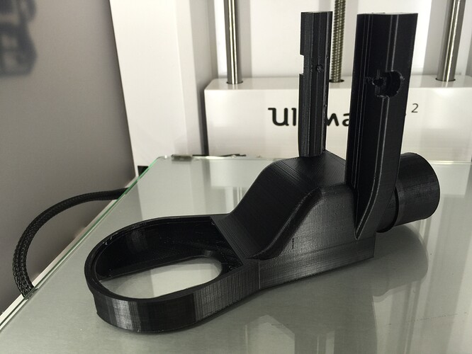

I made my own fixed design. Nearly 2" material clearance.
Attach without having to drill or modify anything on the X-Carve.
Unfortunately I don’t have any files for this, my X-Carve is still waiting for its X-Controller. I made this with my old fashioned scroll saw.

Thats a nice idea. It might still be doable, just look for metal stick that will fit in the slide and then use neodym magnet on the 3d parts so it can be easily change the height.

Or any other type of magnet cup to the bottom of the Carriage.
These washers will help keep the weight down
I would probably go with the Magnetic Cups though.
They can be used to align the magnets like index pins. With neodymium magnets, the shoe should be securely attached bc of the shear strength of the magnets.
I usually pick these up at woodcraft.
Two 1" magnets with cups should suffice but I would probably go with four considering the weight of the hose and the movements

I designed the mount and I use makita on 611 mounting. I have separate post for makita adapter for 611 mounting.
In short this shoe should be compatible to both as long as you use the 611 mounting.

Thanks again FrancisMarasigan. I greatly appreciate this design. I printed mine again last night, this time in black.
I noticed you put supports on the rails, but I always print in a different orientation due to the lip at the front (or top in your orientation).

I bent some 1/8 inch steel plate into two L shaped pieces (about 1 inch wide) and epoxed the long leg of the L to the spindle holder. Then I was able to use magnets in my dust shoe to hold it to the bottom of the spindle mount.

Did you guys have these 3D printed in PLA or ABS?
For this application I think either material will work fine (more detailed comparison). PLA tends to be a little bit stronger, but more brittle material (little bend before snapping). ABS is nearly as strong, but more flexible (still rigid, but tends to bend a bit before it snaps) and slightly more heat resistant.
If you find either material breaks you can use acetone (commonly known as nail polish remover) to ‘glue’ the ABS version it back together, or use friction welding or an acrylic glue/expoxy to glue the PLA part back together.
