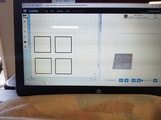

I haven’t really had issues centering… however, lately I have… I am cutting coasters right now… however, what’s showing in easel and what’s coming out on the piece is way off… I have had other pieces that this has happened to, however, I am just posting these two pictures for a better idea… Brian

@BrianRodriguez are the dimensions of the squares correct? As Russell said, when the carve is done, where does the router’s position end up? Over the front left corner?
When the carve is done it goes back to the home position… bottom left corner

Yes sir!! And just ran a test and it is showing that I am 5/8" of an inch up further than center and 5/8" of an inch to the right of center

Did you use the center material in easel?
I noticed the center to material option is off and a carving I am doing is way off.
That is what i was using and it was off .5" on my project. Thing is it was also centered in the grid so i think it is an easel error. I might be wrong but i know how i set the zero on mine and how it was set up in easel it should have been dead center and it was’nt.

Can you share the Easel project and/or the gcode?
Here is a video of two pieces I have attempted. The one on the left was before the xyz position upgrade on the home screen and the one on the right is after. Not sure what changed or if it is operator error but, the “Center to material” menu option seems to be in error.
