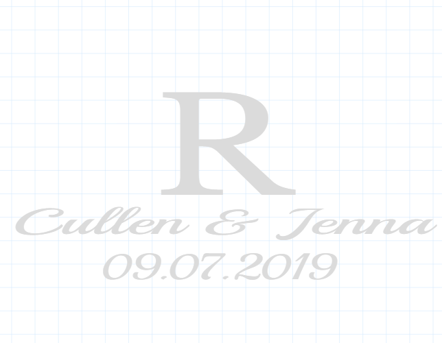

@WayneHall What you might be seeing is an issue with how the text box works. It is centering the text box, but not necessarily the actual text. If you use the X-ploder app to convert the text into its components, I think you’ll get the results you want.
Let me know if that makes sense or not.
Text Box:
Text converted to an object:

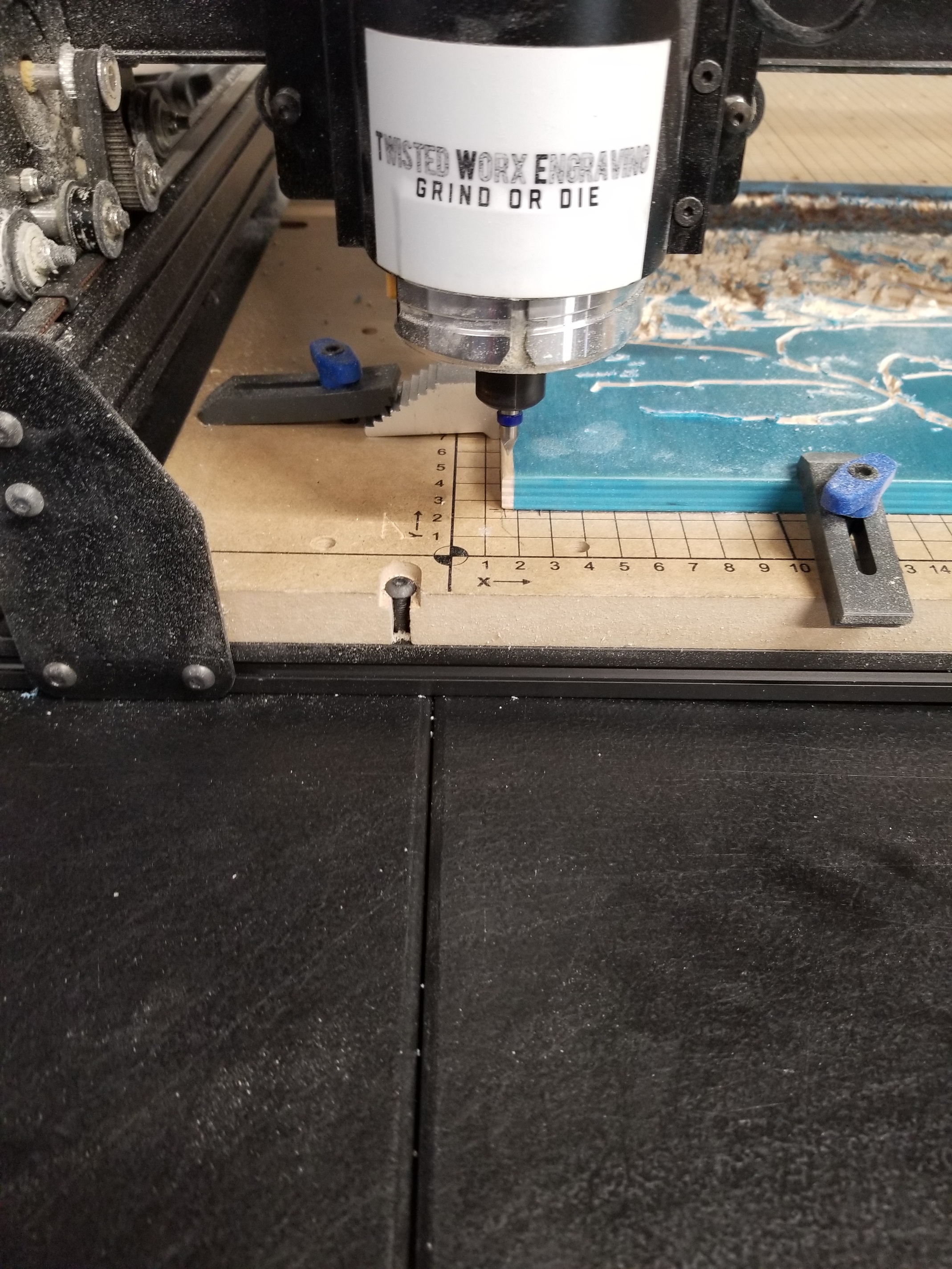

So I did this star as a test piece…This is what it looks like and then the adjustment I had fo make on the spoil board
and that’s with everything centered in easel
@BrianRodriguez I’m confused. Is your XY zero actually over that origin point on the X-Carve?
For the star,
What are the exact dimensions of your stock?
Where exactly did you set your XY zero
Can you share the Easel project file?
I saw that when i sent it and figured it to be the culprit. It really should not be that way. If you click center to material it should center it. I guess i will need to double and triple check from now on.
I think that’s just how text works…not an Easel thing, but definitely frustrating. The same issue happens in any (that I’ve used) design program.
What you see on the spoilboard is the adjustment I made to get it centered. Off by 5/8". The star that i carved was prior to making the adjustment
