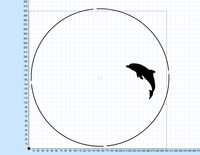

Can any one explain why the router travel out from the material
and start cutting away fron the edge of the material
I have the staring point at the center of the circle

ok so your using a 300mm x 300mm stock correct? and are you setting your home starting point to the left bottom corner before?

ok that’s the problem, you have your starting point set to left bottom. select your image then select the shape tab next to the cut tab and select the center dot

when you press simulate and play, where does it show the bit starting from?
From the bottom
it keeps showing the bit starting from the left bottom corner. Looks like a bug in Easel. @Zach_Kaplan @JDM can you look at this, easel is not updating the starting point to the center start of the project.

I think you have a flaw in your work flow.
If your design is as seen in the link and you jog spindle to the center of the design and make this your zero point…
…then Easel think your zero in the lower left, therefore moving approx 150mm up to the right.

May I suggest you do exactly as before but use my revised project instead?
Place your router at your material center, zero at top of material and hit Carve using my version.
