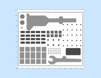

I have a x-carve and trying to carve a tool board but it will not cut into the board but about .093 inches
into the board. Told the machine to cut .50 inch. but cuts no more than .093

I am having the same problem with 1/4 mdf. I measure all 4 corners and set to the thickest dimension. Some of the pieces in a 2’x2’ piece especially in the back half of the board don’t cut all the way through.
I am using 3/4 in. pine

You router is probably not parallel to your waste board. Did it just start this or has it always not cut through?
It has been doing this from day one. I have measured the rails and they are parallel to the cutting surface. I have used a framing square to make sure the spindle is correct.
A lot of people including myself have place a waste board on top of our waste board and took a skim cut. That way your router is perfectly parallel to your work surface. You say its not cutting all the way through 1/4" MDF, is it just a little bit? If so then doing a skim cut on your waste board will help out.
If you command Z to raise or lower 1" is the actual travel also = 1"?
