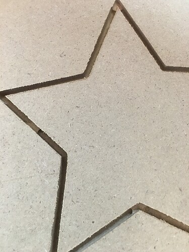

Ok I’ve searched and can’t find a solution. When I cut with easel it won’t cut all the way through the material leaving just the tabs
Example wood is 3/4 thick can’t seem to set the depth below 3/4 in easel it won’t even show up as a cut through in 3D preview??? It’s driving me nuts. Did I not set up something right in the software or drivers ??? I’ve had to chisel out every shape and design

Can you send a link to your Easel file and a pic of what happened?
Check you material thickness, just because you bought 3/4 it maybe a bit thicker?
Good call @GlennMDutcher do you have a digital caliper @NeilBerkeley?
I did measure the material with digital calipers and entered that into the z measurement
That is correct yes ?
Top and bottom of work
Screen shot of what I had before cut that doesn’t seem right only one shows up on 2d pane

Maybe you set Z0 off just a bit.
Or your machine is a little off. It looks like it cut all the way through in spots

I’ve had this problem, and it turned out my wasteboard wasn’t perfectly flat. MDF tends to have slight “waves” in it. After resurfacing the wasteboard I got a better cut. I usually just add a bit to my material thickness though.
Are you using a ball-end bit? I had the same problem a while back until I wised up and realized I wasn’t using a flat-end bit.
Calibrating your Z-axis is also a good suggestion (@PhilJohnson), as is leveling/resurfacing your wasteboard (@Rusty).
Still not getting through it ?
Material dimensions
23.75x7x0.27
Actual
23.75x7x0.25
Work in progress ![]()
Why can’t I put a negative number in cut depth??
And yes this dummy was using a ball nose bit
