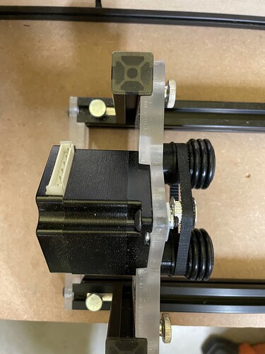

Steps involved:
Buy a roller from Joe@ https://www.ftgincorp.com let him know its for a X-Carve!!
(if you have upgraded and have the spare steppers - He will give you the option to use one or if you prefer he will supply)
Install Lightburn - recommended software
Ensure your setup is working for using a laser - i used a Jtec Laser - follow online for setup
PAWPAW has excellent videos - (4) How to Install the J TECH PHOTONICS Laser to my XCarve - YouTube
Once you all setup then do this next.
  1. Ensure your Power is OFF on the x-controller/xcarve!!!
  2. Remove BOTH Y-Axis cables from the X-controller
  3. Remove the Y-Axis 1 cable from the Stepper motor and take out the cable from any routing you have so you have the full cable loose and independent from the x-carve (you can also just an extra cable instead…Im tight as the shipping for a cable is stupid!)
  4. Position your roller on the x-carve board - suggestion is Facing the x-carve logo from 10/10 (bottom left) have the rotary positioned so that it runs with the stepper motor facing away from the X (see picture)
  5. Clamp down your rotary to the board
  6. Using the Y-axis1 cable- put into the rotary stepper motor and other end into the xcontroller - Y1 Axis port - ensure the cable in low around the side so it doesn’t get caught anywhere
  7. Open light burn - you should have it already setup for laser use, if not then follow the steps to setup a laser
  8. Highly Recommended but not required - create two Macros in Laserburn for the rotary
  9. See picture for my setup - I did this as i used my old xcarve steppers i had left from the upgrade. they have different settings the the new stepper!!!
  10. Check your macro by looking the the $$ outputs ensuring they are working
  11. Ensure you are now on the correct setup for the rotary - use your new macro!
  12. Open Tools-Rotary setup - change to Roller
  13. Rotary Axis = Y
  14. Enable Rotary
  15. Enter the values in the first two - you need to have these correct - suggest you start with my value first and then dial in to your setup - Rotation & Roller diameter-see picture
  16. now the next two options you have a choice from what i have found, you only need one to be completed as the other will auto complete. so work out your “object” this is what you are going to laser…in my case i used cheap amazon cups to test things…
  17. Click “OK” to save things
  18. Now you need to change the Job Origin - this can be tricky - im till working this out :slight_smile: i choose “bottom right”
  19. Now we need to position the laser to the rotary
  20. There are Youtube video on this i suggest you watch to get an understanding - i used this one to understand:
  21. (4) Laser Rotary Setup and Calibrating Steps per Rotation Using Lightburn - YouTube
  22. Put your “object” on the rotary with painter tape around the top circumference and mark a line like the video above…ensure it horizontal! :slight_smile:
  23. move your laser into position (check height of laer from object!) using the “fire” laser feature in lightburn to set the laser position hitting the pencil mark on the object.
  24. Once set - hit the “framing button” - I found that using the Framing feature of lightburn helped alot!!
  25. this will rotate the object and if your settings are correct spin and then come back to the original position. check the “fire” laser and it should be on the pencil line again. if not then you need to check your rotary settings
  26. Once all set - do a test laser…i did some text as i wasnt sure on the orientation against the rotary - i.e will i be upside down or back to front when lasered…first time i had it back to front…hence framing is key so you can see rotation :slight_smile:

UPDATE on Rotray position and laser setting for Job Origin…
I have found it easier to build a template as such and save this…see pictures and change the rotary to face per the picture…rotary stepper away from 0/0 X/Y
Then save a template with top/bottom so you know which way for your lasering…YT email tips!
