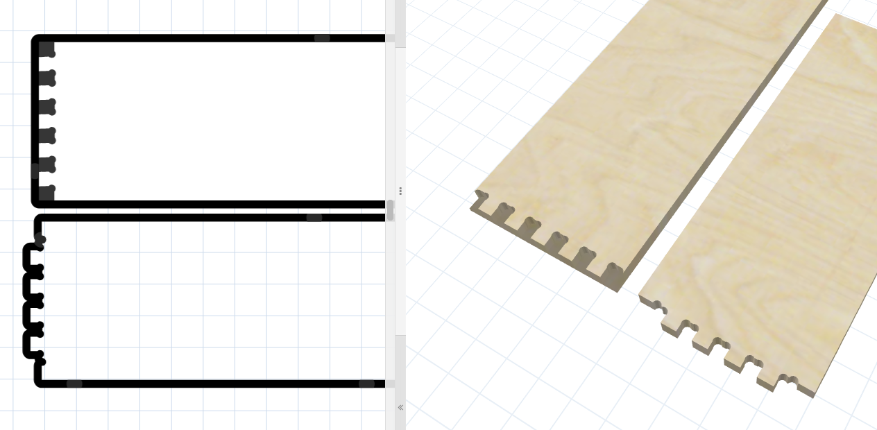

You can make box joints on a CNC flat, but you have to have add dog bones for the corners, because the CNC cannot cut a square corner (or manually square the corner, I guess). I don’t think this would look very nice for a drawer. It’s fine for a utility box. I’ve used this when I was going to cover up the joint.
I do want to make a pass-through for my X-Carve Pro bed, so I can cut end grain. However, I’m less interested in strength than creating interesting boxes with unique join patterns. For drawers, I’ll probably just stick with the rabbet since I’m not building anything that needs exceptional strength.
I just had a thought: I suppose one option would be to make half-blind box joints? I’m thinking off-the-cuff here, but you could theoretically only cut 3/8" through the sides, so the dogbones would be hidden. Then cut the front and back like normal, since you won’t see those surfaces. I might mock this up.
Did a quick mockup in Easel, and it’s a real pain in the butt to set up without some sort of generator. Technically it could work, but this feels like an exercise in frustration unless you were knocking them out commercially.
Here’s a screenshot of my first attempt (though it’s way too sloppy to work):
At least you get a sense for what I mean. The drawer side is on top, and the drawer front is below. You’d get about a 3/8" x 1/2" overlap for the fingers to glue up, so more than enough strength. I have it configured for a 1/4" bit (my workhorse for big projects), so the dogbones are pretty large.
I’d imagine it would prove to be tricky to get everything fitting nicely without a few trials.
You can see the mess here if you want to try to iterate on it.
