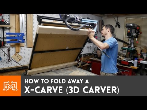

What about having it fold up out of the way when you’re done using it? Would that help? YouTube has many videos showing these kind of designs. I’ve posted one example below for you;
My concerns for having it at an angle would be the same as others have stated. Gravity is going to do its thing and parts many wear unevenly. There is one design where the entire X-Carve flips upside down and it turns into a workbench. It was posted online a day or two ago, and when I locate it I’ll post it here for you to review.
