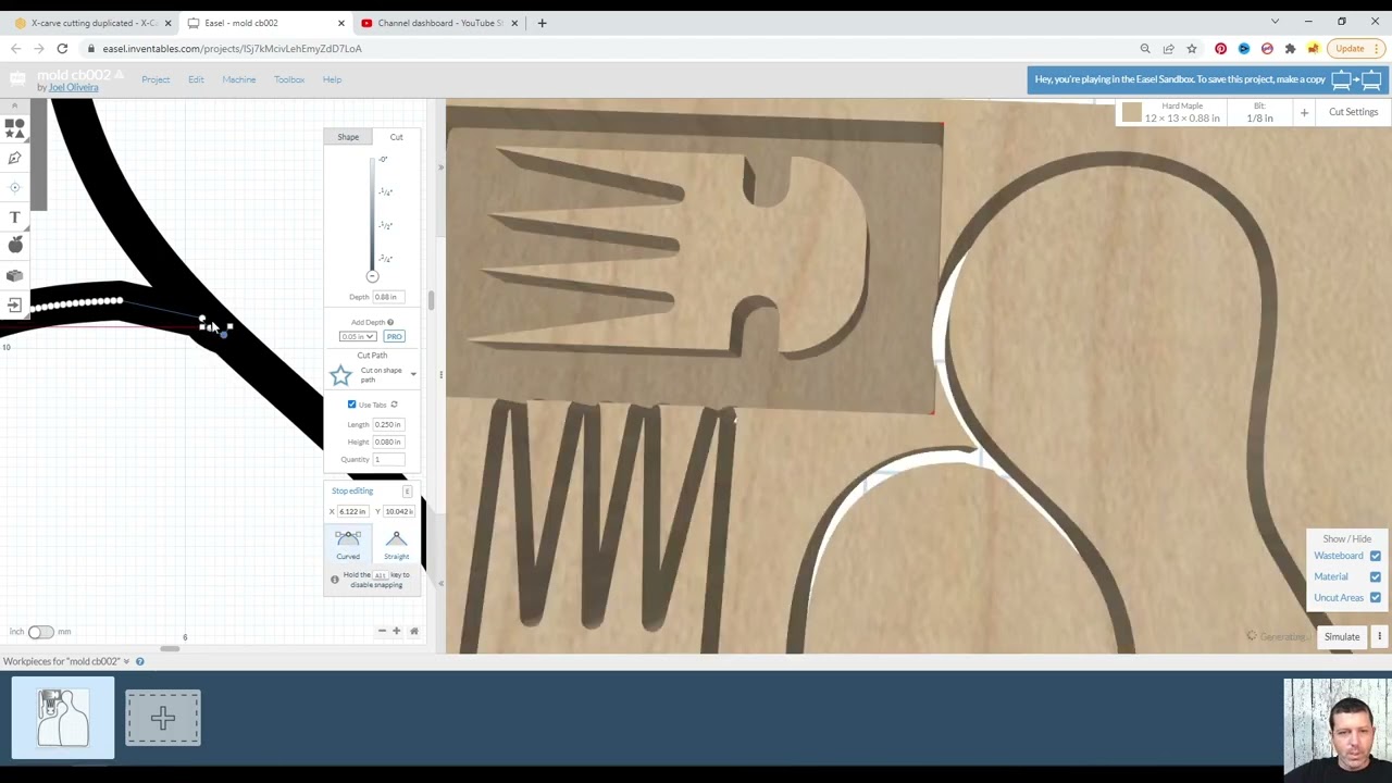

Hi, my xcarve i set to make a cut, then i make the zero ok, the machine do the first cut good, then when its come back to make the way through deep needed, it come and make the cut on like the side and screw all the project, I review all the simulation thing and by there is right way.
This is common when a image tace is done with thick lines and the lines are traced inside and outside.
Can you share the project?
I can make a video showing how to fix this specific project

In addition to what I covered in this video,… looking at your last photo after ended the video, it looks like there are also lost steps in the X, so check belt tension and V wheel adjustments, these are also covered in the calibration section of the manual… Here:

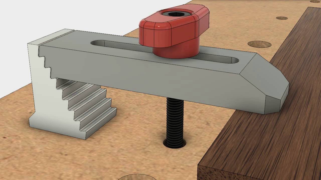

Edit: the Clamps:

and again thank you so much, ill adjust the clamps too
