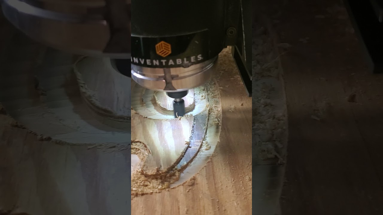

So I’m getting these grooves in my cuts as you can see in the bottom pictures. I’m doing a roughing pass with a 1/2" bit and a detail pass with an 1/8" bit. Where it cuts the 1/2" bit section it is higher up than the border that is cut with the 1/8 bit. what’s strange though is, if you look at the picture with the 9 carved out. it only extra ridges on the right side. I carved 4 of these all in all 4 corners of the total cutting area and they all had a similar flaw.
If you look at the texas shape it’s clearly not even close to the same depth, and I used the z probe when setting up both the roughing and detail carves. any help would be greatly appreciated
here’s a video where you can see the roughing pass not cutting evenly

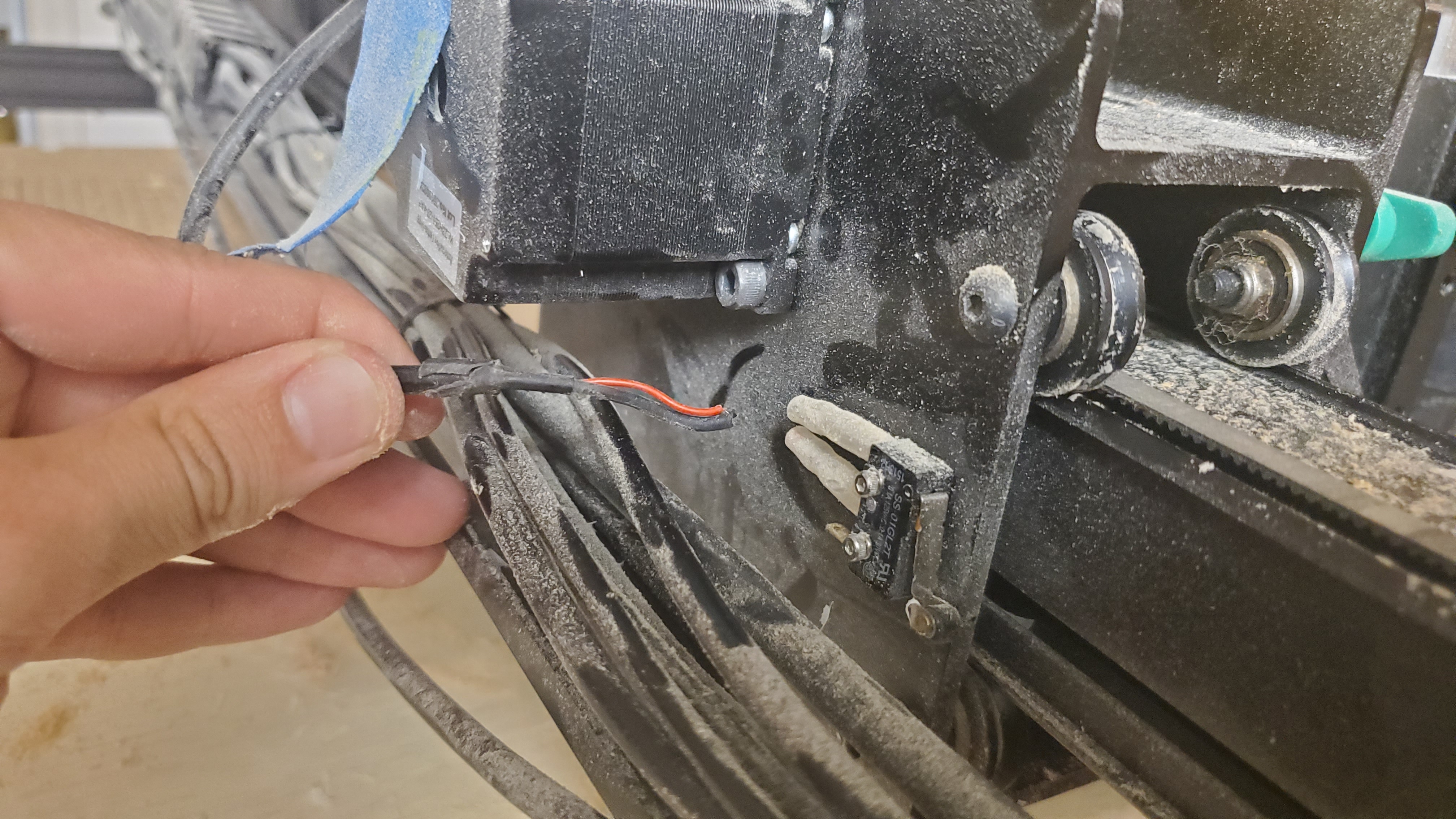

I’ve seen people mention loose wires potentially causing missed steps? these wires were broke when I got it home, didn’t notice at time of purchase. I believe its the wires that tell it when to stop moving. could this be causing a problem?

@RussellCrawford here’s a video where you can see how that groove is being made. it happens on the roughing pass alone. is this a z axis not being square to the table issue?
I don’t see the video but if its happening on the roughing pass then something is loose or the material isn’t secured good. Can you wiggle the router?

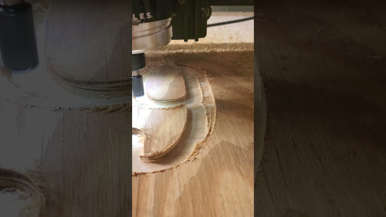

@RussellCrawford Here is a video of the new test. Unfortunately, the same result have occurred. The v wheels on the z axis seem very tight, if I try to move the wheel with my fingers the whole carriage try to move. Idk if thats good or bad.

It’s weird it looks like it’s just missing spots all together?
What does the tip of that bit look like? does it have blades going to the center? or do the blades stop at the sides?
Russell
The blades do not go all the way to the middle
@RussellCrawford were you able to see the last couple videos I posted? I know you said you couldn’t before, but they may help in the diagnosis. It looks partly like a z axis thing, but it also doesn’t explain why the 1/8" bit was cutting deeper, and why it was also cutting different sized circles
I saw the videos, I can see why that 1/2" bit will give you trouble but the 1/8" bit should cut good. Did you try using just the 1/8" bit?
If you go deeper that than the blades on that 1/2" bit it will push up on the Z axis because its not cutting.
Russell
Oh I see. Cant go any deeper than the space between the blades and and the middle shaft of the bit? That makes sense… as it’s plunging that middle part ain’t cutting, but once it starts moving won’t it level out?
