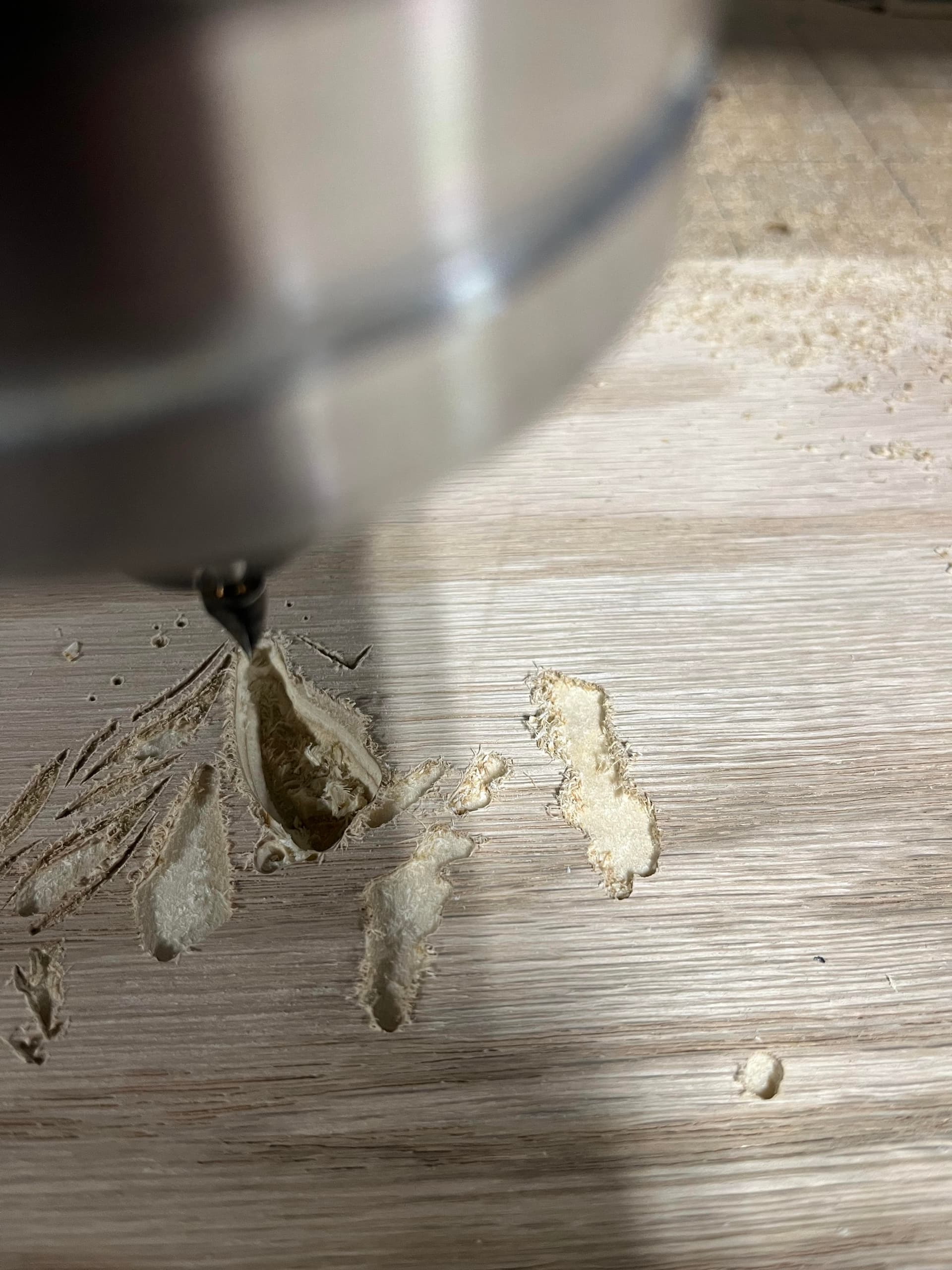

I have used my Xcarve sporadically for a couple of years. This year I started using it much more. I have successfully completed a number of projects until recently. All of a sudden things have been going haywire. First I started noticing about halfway into a carve the machine not able to clear the material to move to the next cut. Then when I stopped the carve and tried to raise the Z axis, the spindle actually moved down instead of up. I was able to restart the computer and Xcarve and go back to carving normal. I successfully completed another carve. Then I tried a new project, the roughing pass worked fine and then on the detail pass things went crazy again. This time the bit went far deeper than the cut or depth per pass were defined. I went on a Facebook group and some people suggested a new USB cable as well as setting up a new machine. So that is what I did. I went into Machine > Set up new Machine and walked through the prompts. My steppers were not moving in the right direction at first but the dialog box automatically reset GRBL so everything was oriented correct. Then I did the test cut which I will attach here. It looked mostly fine except for one of the eyes wasn’t perfect so I figured I would try another carve project to test it out. The roughing pass went fine but then the detail pass drove the bit into the material way deeper than my settings on one particular section. I have also attached the photo here. I am using a 60 degree bit for detail and the cut settings are Cut Depth = 0.0469 in, Feed Rate = 85 in/min, Plunge rate = 22 in/min, Depth Per Pass = 0.025 in. Any ideas on where to start to troubleshoot?
What type of Z-Axis do you have?
Have you checked the stepper motor electrical connections?

It was the Z axis red wire on the controller, it was loose! Thanks. I also noticed a number of my V-wheels were loose. After tightening them not all of them turn when I manually push the router along the XY axis. I have tried loosening the ones I tightened to see if I over tightened but that did not change things. Shouldn’t they all engage and rotate? I also slightly damaged one of the connectors on the stepper motor side, part of the white connector broke off when I was removing it. The black lead has part of the wire exposed. Do you think this is a problem? Do you know if I can just replace the white connector without replacing the entire wire assembly?
The v-wheels should be tight enough against the rail such that they are not loose, they can be forced to rotate with a little applied pressure, and are not so tight to force the wheel into the rail too much as this will cause the wheel to split into two pieces.
As far as the connector goes, is it on the cable? If it is, you can replace that one. Until you can source the replacement part, you can put some hot glue over it to keep anything from getting into the connector and shorting it out as well as keep everything in place. A picture is worth a thousand words here. Can you post one of the broken connector?
