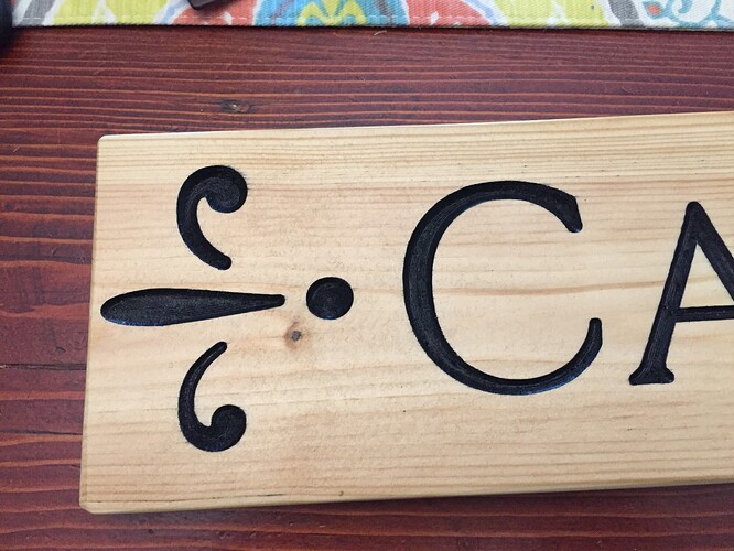

Glad you found the issue was just feed rate, I don’t use Easel much, but never noticed an issue with the signs,
this was default birch ply (on pine) with an old dull HSS V bit… bamboo is harder!
