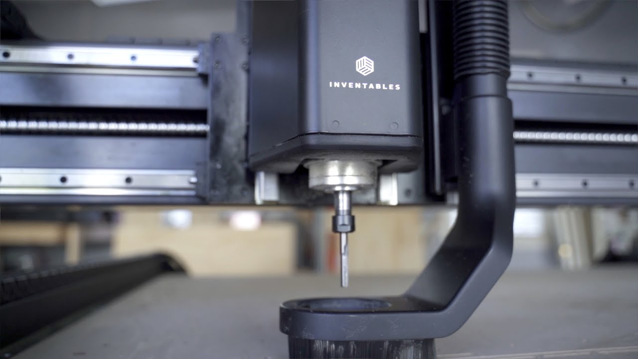

Sorry if this is a dumb question but does anyone know if there are any touch probes that work with the X Carve Pro? If so, what would I need to get one to work? Obviously the probe but would I need an additional software program as well? Thanks I’m advance for any guidance anyone can provide. Be well.
No special software is needed for the z probe… easel works with z probes just fine.
(Jump to 7:18 of this video to see it in action)
if you wanted to use a xyz probe you could export the gcode from easel (or your preferred toolpathing software) and the send with more powerful sender line openbuilds control, with a xyz probe wizard built right in. Some people prefer UGS as their sender, it also has a process for using xyz probe as well. (Of course these both also support the same z probe shown in that first video as well…)
There are a few thousand X Carve users that use the Triquetra 3 Axis touch plate. Search this forum for Triquetra Touch Plate and you will find more reading than you will want to consume.

Sincerest of thanks for your thoughtful responses. This will definitely help me out. Very much appreciated. Have a great day and be well.
