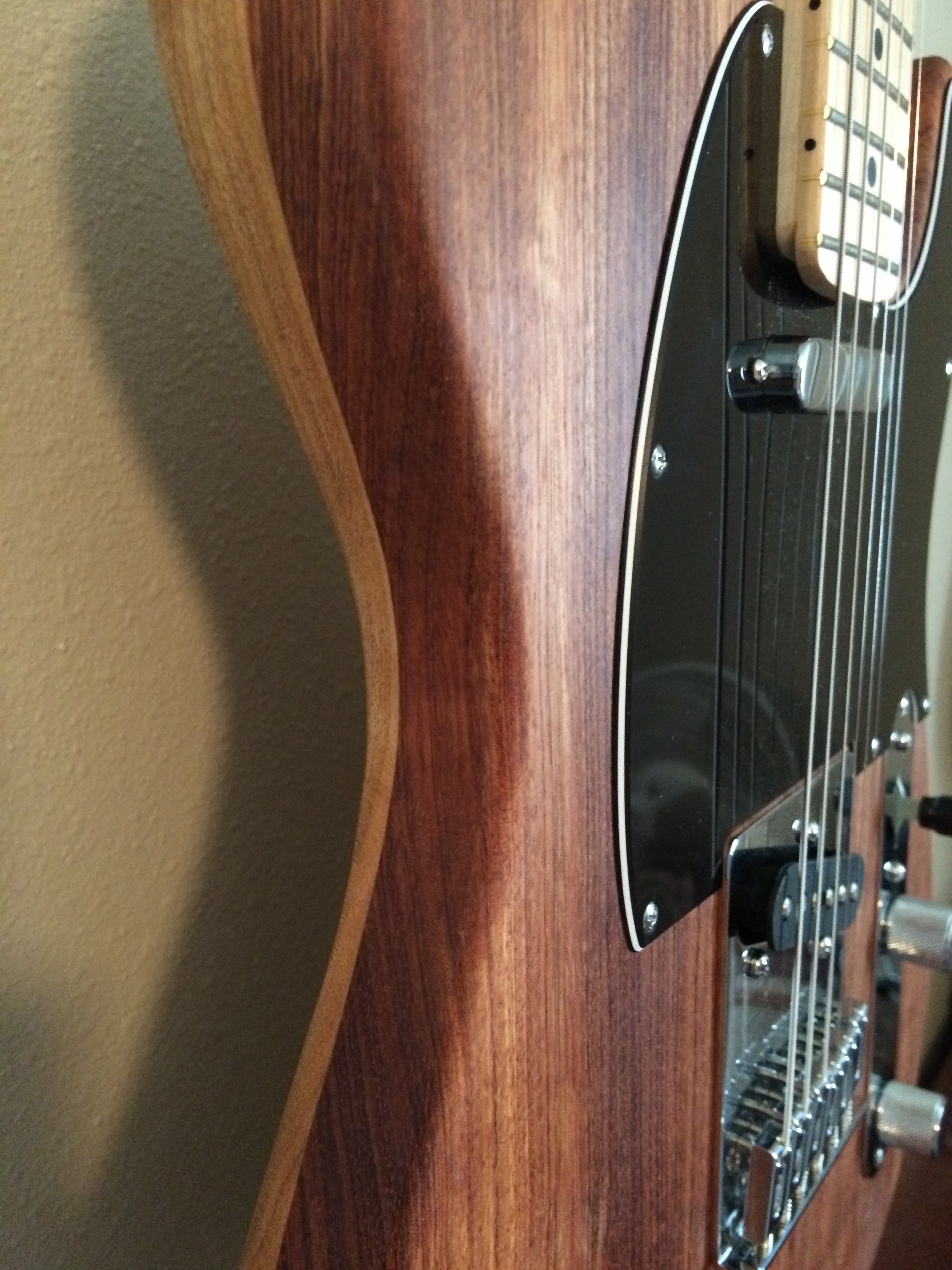

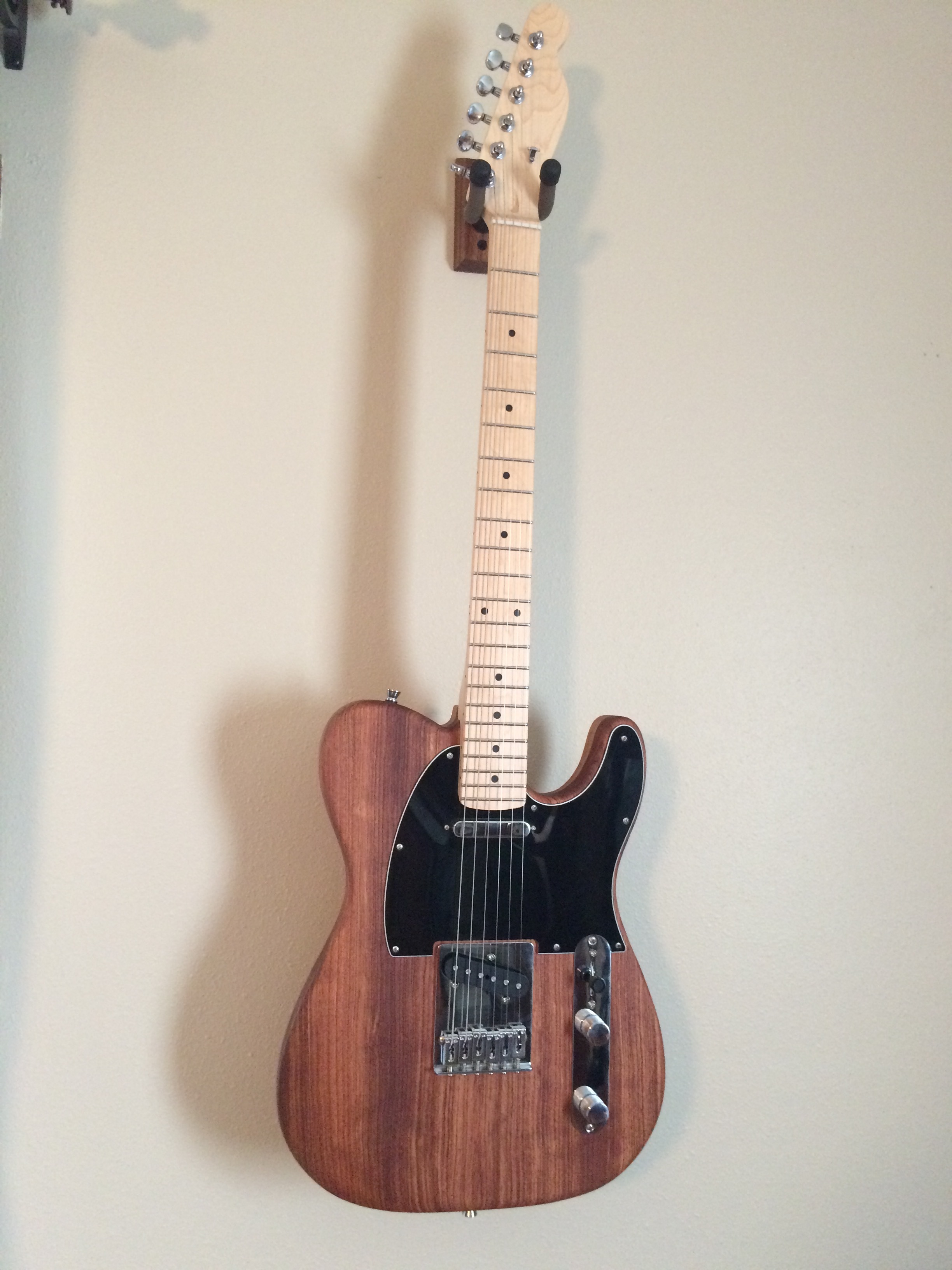

Well after a few tests and a couple weeks of work I was able to complete my first custom guitar over the weekend.

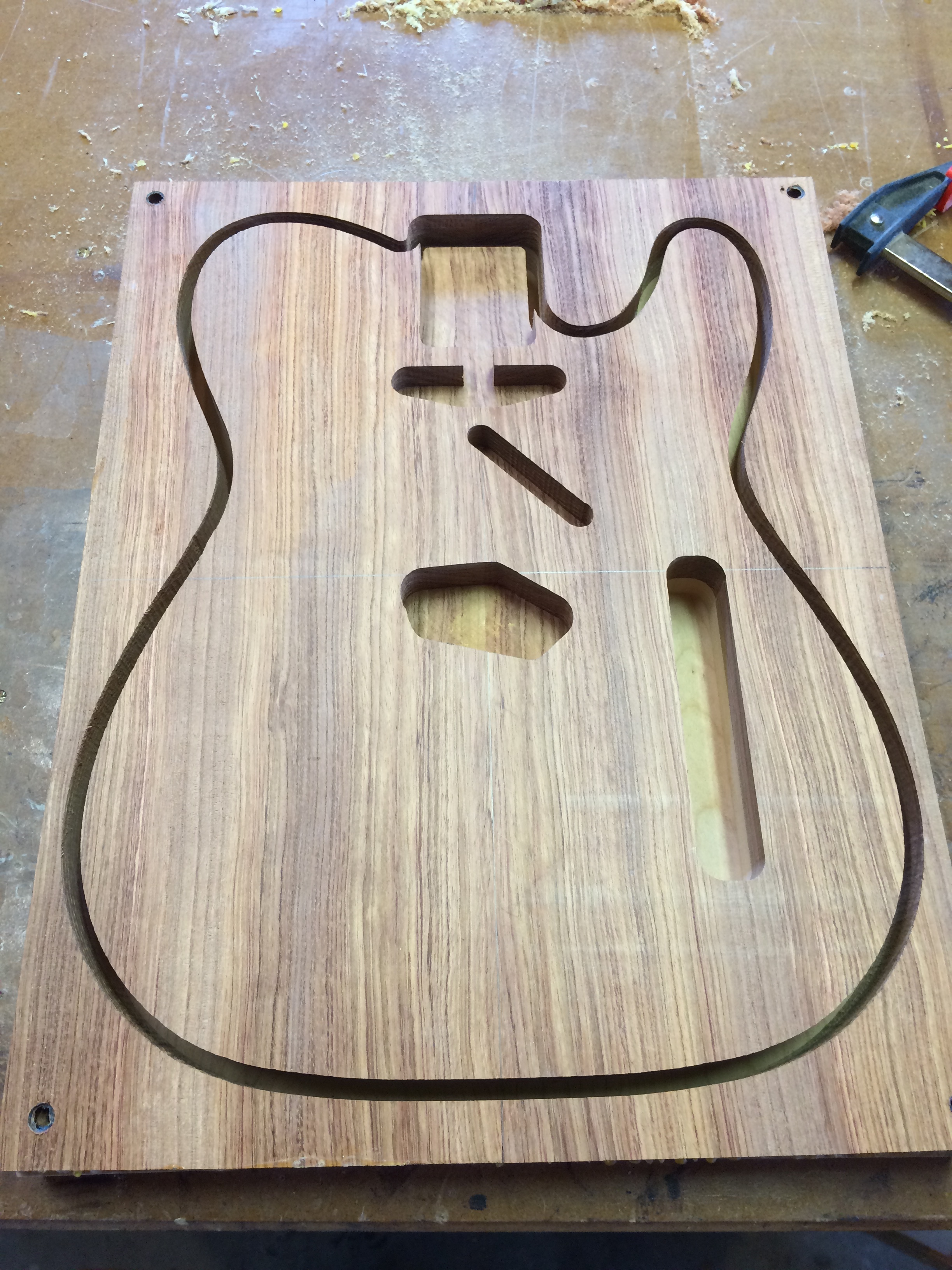

For this attempt, I glued up a blank of cherry and bubinga (my first was going to be a solid walnut blank, but due to a mis-measure on my part that blank will not become a guitar and I had to pick up a new 1/4" spiral bit after hitting a hold down screw :frowning: ).

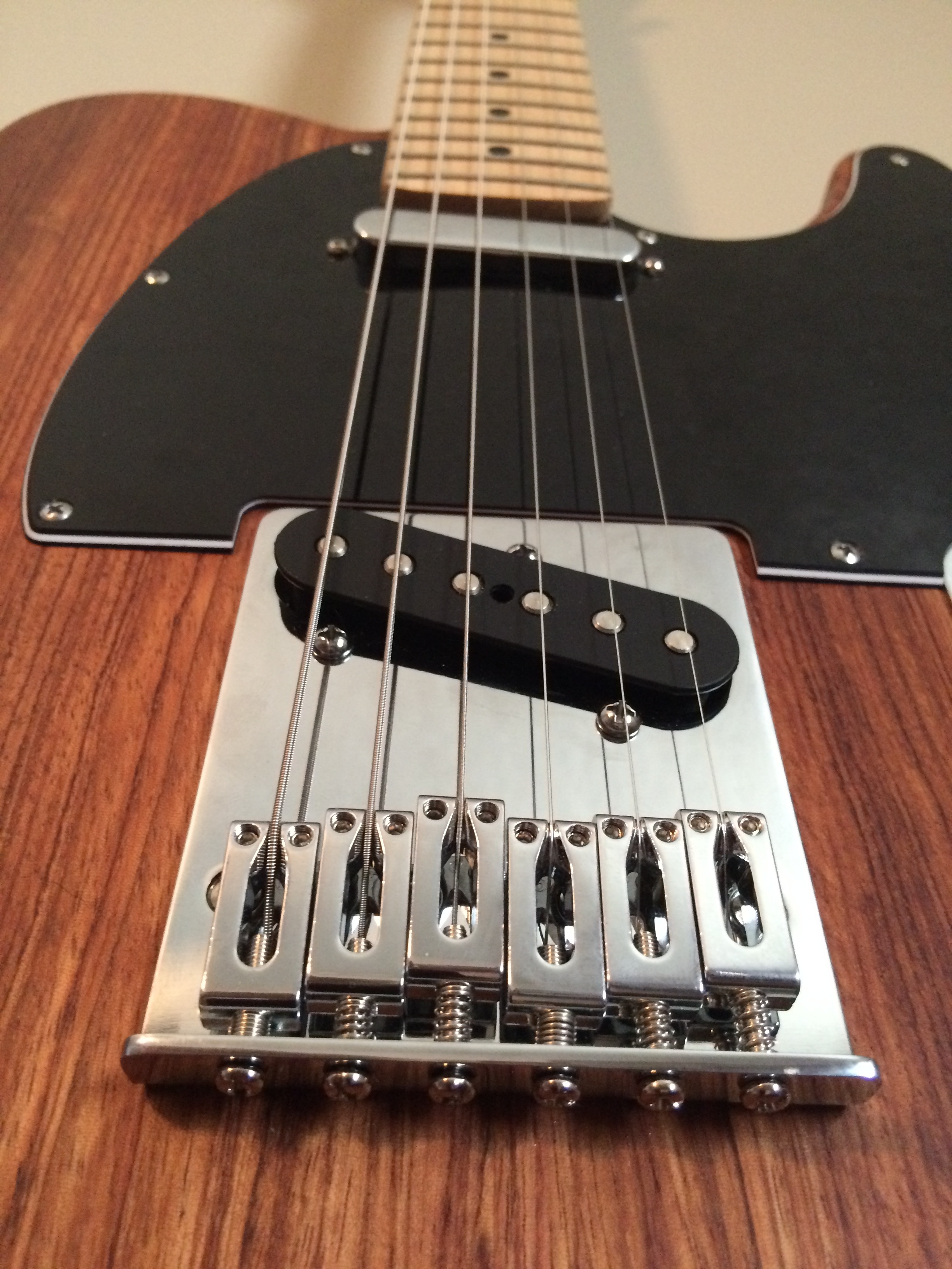

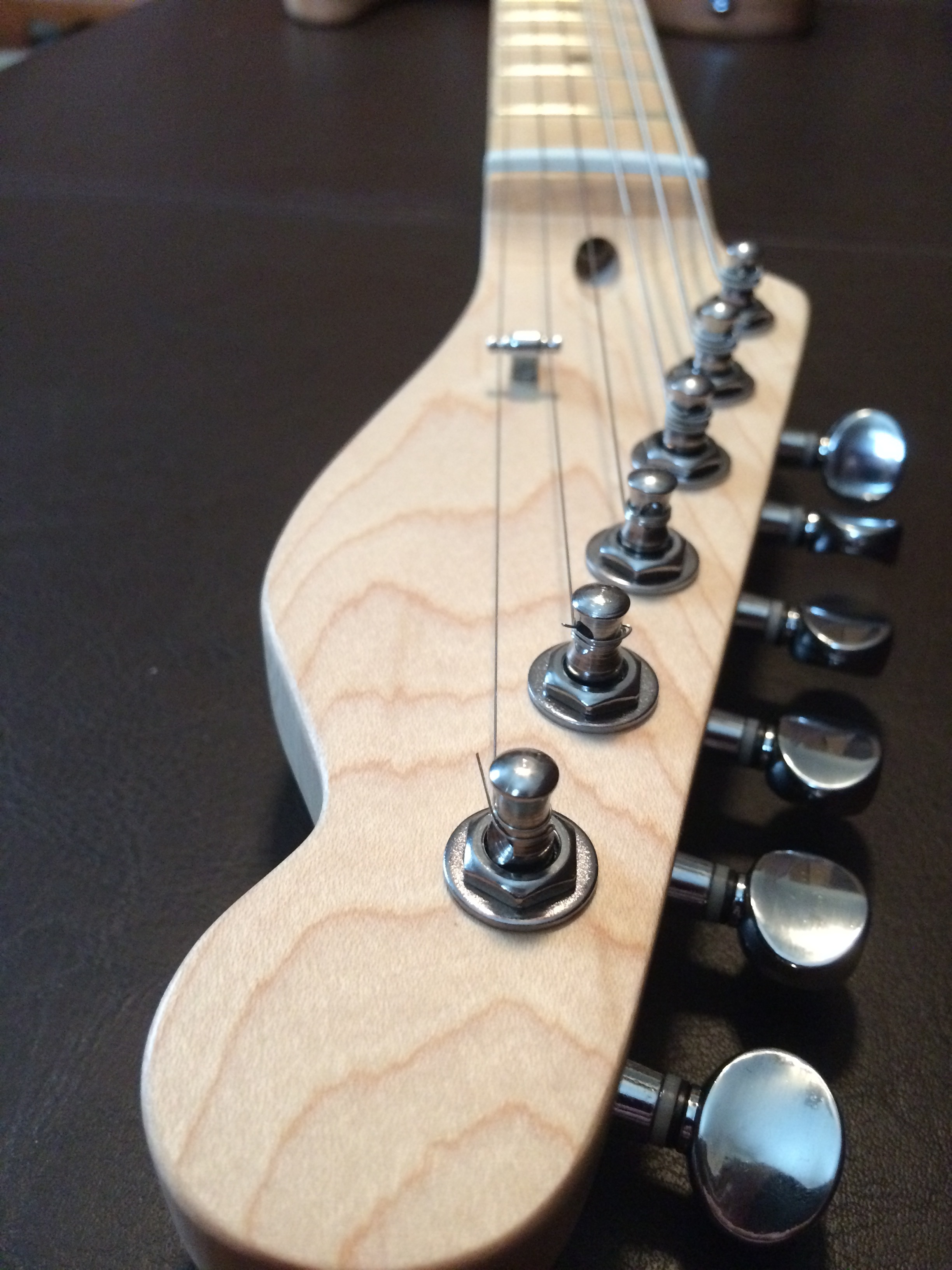

I purchased the neck, I found that for telecaster necks the main difference in quality come in the level of finish to the frets and the quality of the nut. I got this neck new for about $40 and spent some time leveling and re crowning the frets and replaced the cheap plastic nut with a TUSQ nut.
The body cut pretty well, there was some chatter to clean up in the bubinga layer. The pockets all cut clean and to the precise size I needed. Everything was cut with a 1/4" downcut spiral bit. I use the DW611 and was able to cut this out in about 30 minutes (next time with such a hard wood I will slow down a bit to help reduce some chatter). I could only get about 1.5" of cut depth with my bit so when cutting out the body I finished the last 1/4" with my bandsaw and flushed it up with the router.

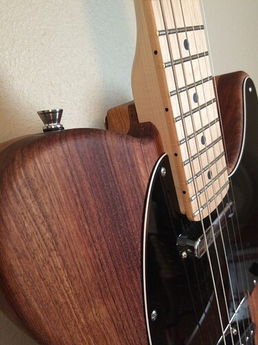

All of the remainder of the shaping was done by hand, with rasps, files and sandpaper. This was the most enjoyable part for me. I incorporated a belly cut and arm contour which you would typically see on a stratocaster style guitar. In the end it turned out great and sounds great too. This was a good test of both the precision of the X-Carve and my own precision. Drilling through holes for the strings and doing the final bridge location were all steps that forced me to slow down and work with extreme care.
Here it is -

How did you combine the two different woods together? Did you use some sort of vacuum bag, or did you use another method?
Id classify myself as a novice guitar player, but to my ear it sounds as good as most of my other guitars. It plays nice, the work put into leveling the frets has allowed a nice low action without any buzzing. The only issue I still need to work on is the height of the string at the first fret, its a bit high so I need to make some slot depth adjustments to the nut.
Overall, I am impressed with how it came together.

The full thickness of the body is 1 3/4". Each species of wood is roughly half the thickness, and my width was enough to have a join in the center of the body. So, the blank is really made of 4 pieces.
I started by laminating together each half of Bubinga and Cherry into blanks that were to thickness and about 1/2 the width. I did this so I could get good clamping across the pieces. Next I jointed the 2 half and glued them together like you would any panel type glue up.
Worked well for me, and having multiple joints didn’t seem to negatively affect the resonance or sustain of the finished guitar.
