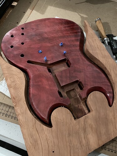

Hi all! I’m excited to share my first ever project made with the X-Carve (first guitar and fourth woodworking project overall): a Gibson SG tribute guitar made in large part with Easel. The body was carved from a beautiful piece of pacific redwood (Easel team please include a double sided carving helper!) with a rosewood neck and ebony fingerboard. Lots of research went in along the way to get all the details as right as possible. I’ll share some after the pics.
X-Carve helped with the body cutout, cavities, bevels, neck cutout and headstock, fret slotting, inlay cutouts, neck pocket, tenon joint, and truss rod channel. I used primarily Adobe Illustrator → Easel → cncJS for all operations. Obviously there was a ton of additional hand work with various saws, files, metric tons of sandpaper, and glue.
My favorite bits to use throughout the project were the spetool 1/4” downcut, the whiteside 1” planing, and tackpro 1/4” 22° vbit.

I’m finishing the whole thing in nitrocellulose lacquer, and it’s just about to begin curing. Sadly I have to wait for that before installing the hardware but I couldn’t resist showing it off now. Here’s a sneak peak with a mocked up pickguard (laser cut plywood), and also my initial easel image!
