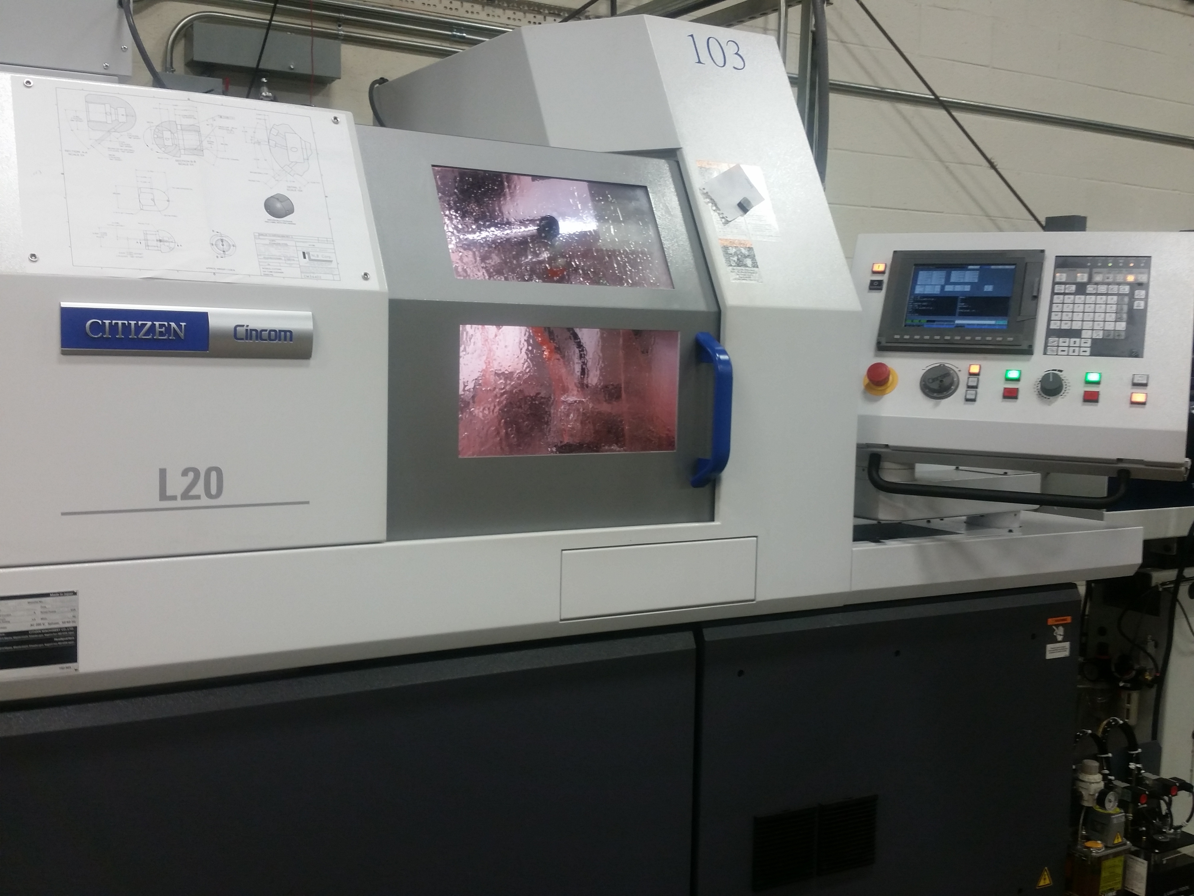

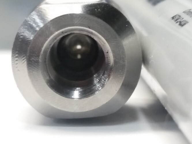

1/32 is hardy compared to the .01 carbide drills I use in heat treated stainless steel at work. lol

its cnc swiss machine. It was tedius at first but now it is a dream…lol
