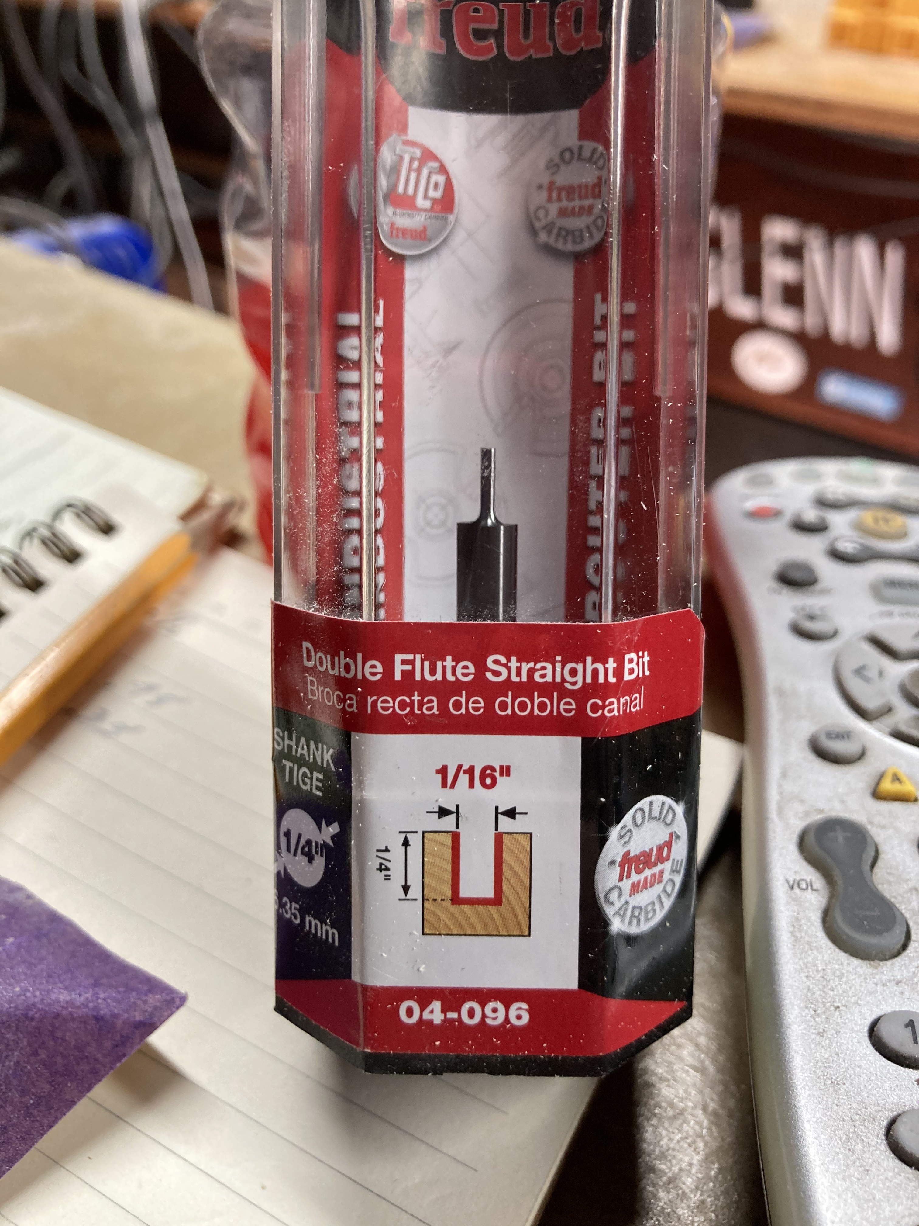

I did a project with 1/2 inch white oak where I was cutting all they way through like a scroll saw would. I snapped a lot of 2mm bits. I moved to a 3/32 single flute straight bit from Freud which I now use for scroll saw type work. That leaves about a 2.5mm kerf.
Those bits should be indestructible at that price! Wow!!
Zirconium Nitride is expensive Traxx. HAHAHA. I am a huge fan of Amana bits, but holy crap that’s steep.
