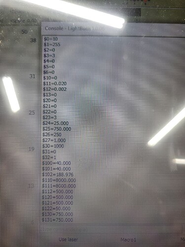

I have a xcarve that has the gshield. I bought a laser jtech and wired it the way it shows but the laser won’t triger. Any help would be appreciated. I have the switch in logic. From what I can tell with a tester im not geting any signal on pin 11. I can flip the switch to on and the laser comes on.
What is your $=30 setting?
$30=1000
$31=0
$32=1

Lightburn also tryed ugs to send a m03 s1000 command didn’t work. Everything else works
Are you sure you have the 1000 set in lightburn. If it does not match your $=30 setting it will not fire.
Yes I doubt checked that as well it matches

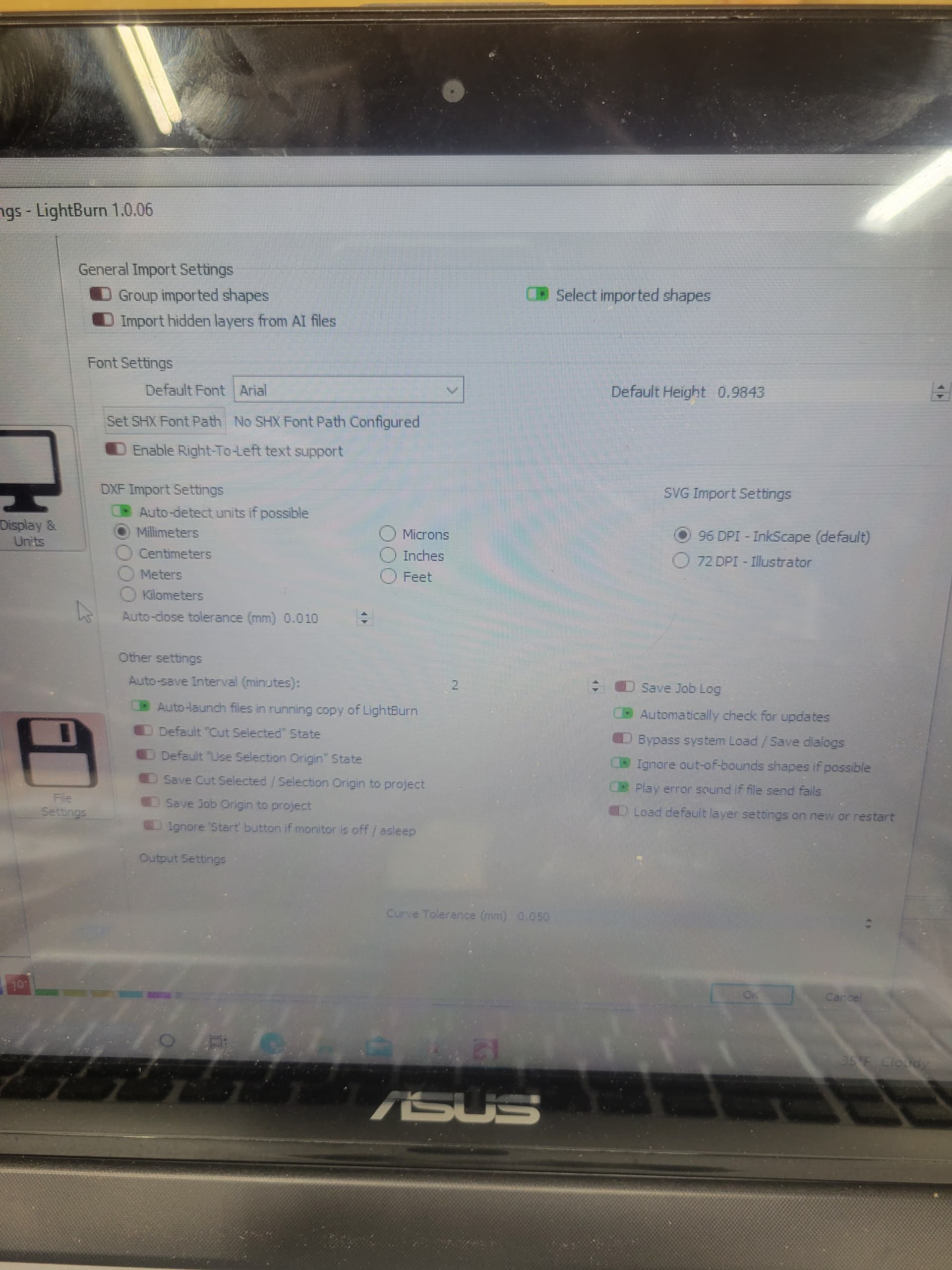

Can you copy and paste your lightburn setting so i can take a look at them?
Yes it will be a minute
Can you show me both the full page setting for lightburn so i can check them with mine?
I don’t see anything wrong. Did you check your grbl setting when you were hooked to Lightburn to be sure your $=30=1000? Not sure what else it could be if it firs manually.
