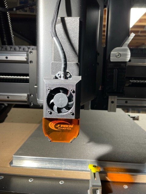

I am currently working on adapting my JTech laser to my XCP. In anyone else interested in that? BTW wouldn’t that be awesome given XCP’s size?
You had any luck with the adaptation? It would be awesome if there was a good way to do this.
I have designed the mount and I just need to find time to cut it and extend the cabling.
No reason this shouldn’t work.
D
I had a few lazy minutes this morning to finish the mount. I made this from .5 Expanded PVC and mounted it to the head just using double sided servo tape. The small block at the top is used to quickly mount the laser so your don’t have to fish around for the holes (those if you who have used this Jtech laser know what I am talking about). It’s solid and should work. Just need to extend my cables.

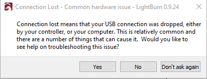

Okay, big step. The laser is active and I am able to adjust the laser strength. I have a new challenge that I came across while doing my first test burns. I am using LightBurn and I had the laser set to a speed of 30 @ 20% intensity. It begins cutting and then after about a second I get a message saying the software has lost connection to the USB device. Upon examining the console after re-establishing the connection it is reporting the GRBL has been locked out because of an alarm state… Any help would be appreciated!
A new version of Lightburn solved this issue. I was able to run the laser from Easel with no issues so I decided to try the latest version of Lightburn. I have been testing this evening and everything appears to work as expected. Project complete!
