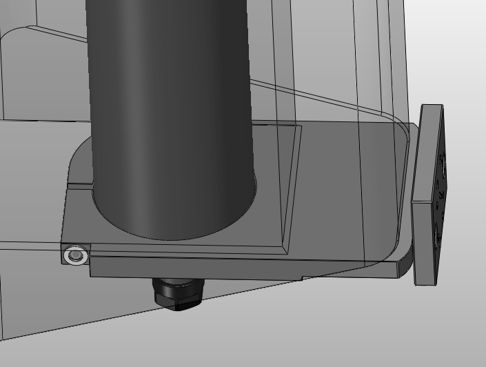

Hi! I’m designing a laser mount for Opt Lasers for X-Carve PRO.
Can you help me with getting a distance between the surface of the spindle (59mm) and otside surface of the enclosure of the spindle?

Hi! Sadly not yet. Some guy spammed my post and covered it with “real estate” info. Can some share the dimension I marked on the photo? This is generally all that is needed to finish the laser upgrade for X-Carve PRO.
measured from the bottom of the spindle to the end of its
Oh sorry, I read that again, you wanted this dimension.
55.72
Thank you @Pascal_Reed !
This is the bottom view.
And some screens from the desing with XT8 and LaserDock PRO mounted:
LD PRO without a cover:
The mount on the spindle:
