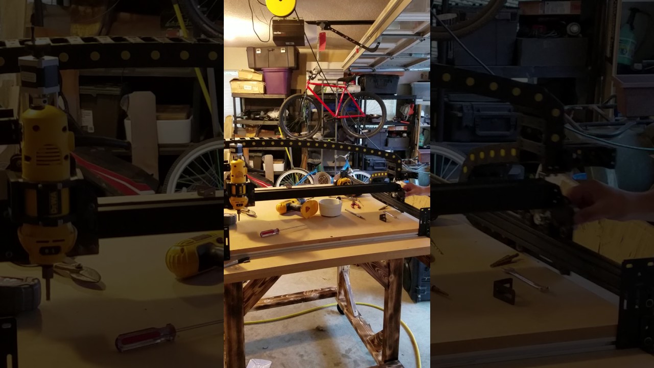

drag chains are installed and operational! Thank goodness I had enough random hardware to make them work. I had to take some links out of the side one to make the gantry chain long enough. Not a big deal though as my cables will be fed from midway down the table anyway.
It moves under its own power! I have everything square but tram is way off. I guess did a poor job drilling the holes on the mount. And the fact that the DW660 has a tapered case. I can fix the front to back with shims in the mount. But I am not sure how I’ll adjust it side to side.
I used pieces of belt to shim the router in the mount. Tram is pretty on point now.
