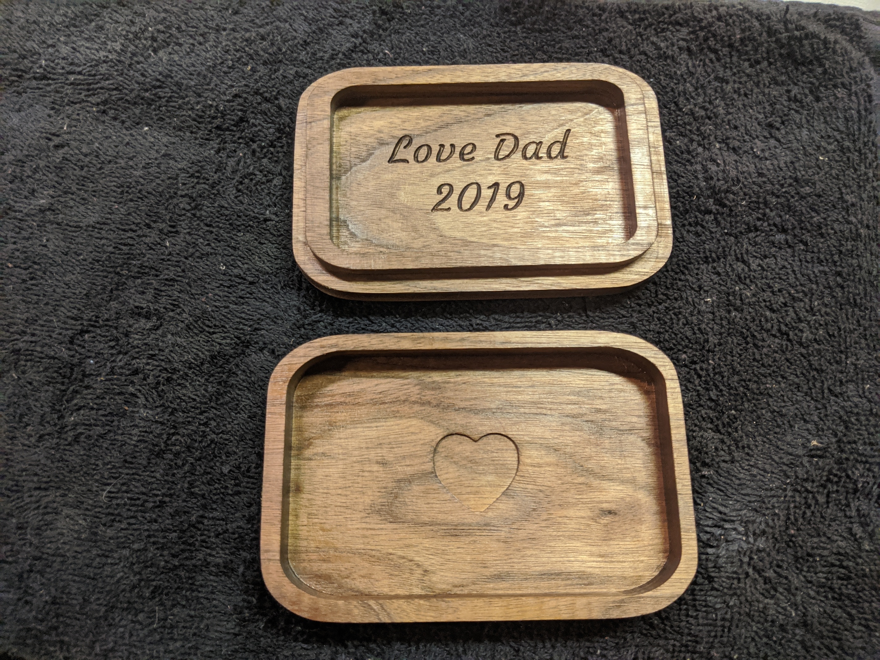

So I just finished up these two projects for the holidays. This was my first run through from start to finish (to include finish sanding and wood treatment). All thoughts are welcome.
The heart was a download from the projects section and the rectangle I did from scratch.

Out of curiosity, what offset did you use between the box “lip” and the lid? How well do they fit?

I copied the inset lip then used the outline cut for the lid and the inside cut for the box the then I adjusted the inside manually to adjust for the tightness in the fit of the lid. I will admit it was not perfect off the machine and did have to do some sanding to get the two pieces flush to each other on the outside but it only took a few minutes with my orbital to accomplish it. The end result is around a 1/32 play between the two. it is close enough to open and close with ease and tight enough it does not have to much play in it.

looks good, what type of bit did you use?

I used a 1/4" upcut bit for the box and a 60 degree v-bit for the engraving.
