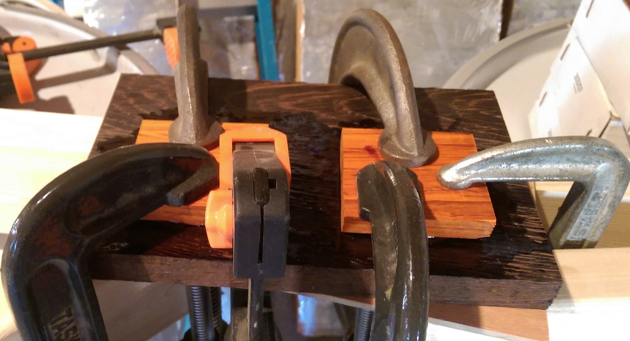

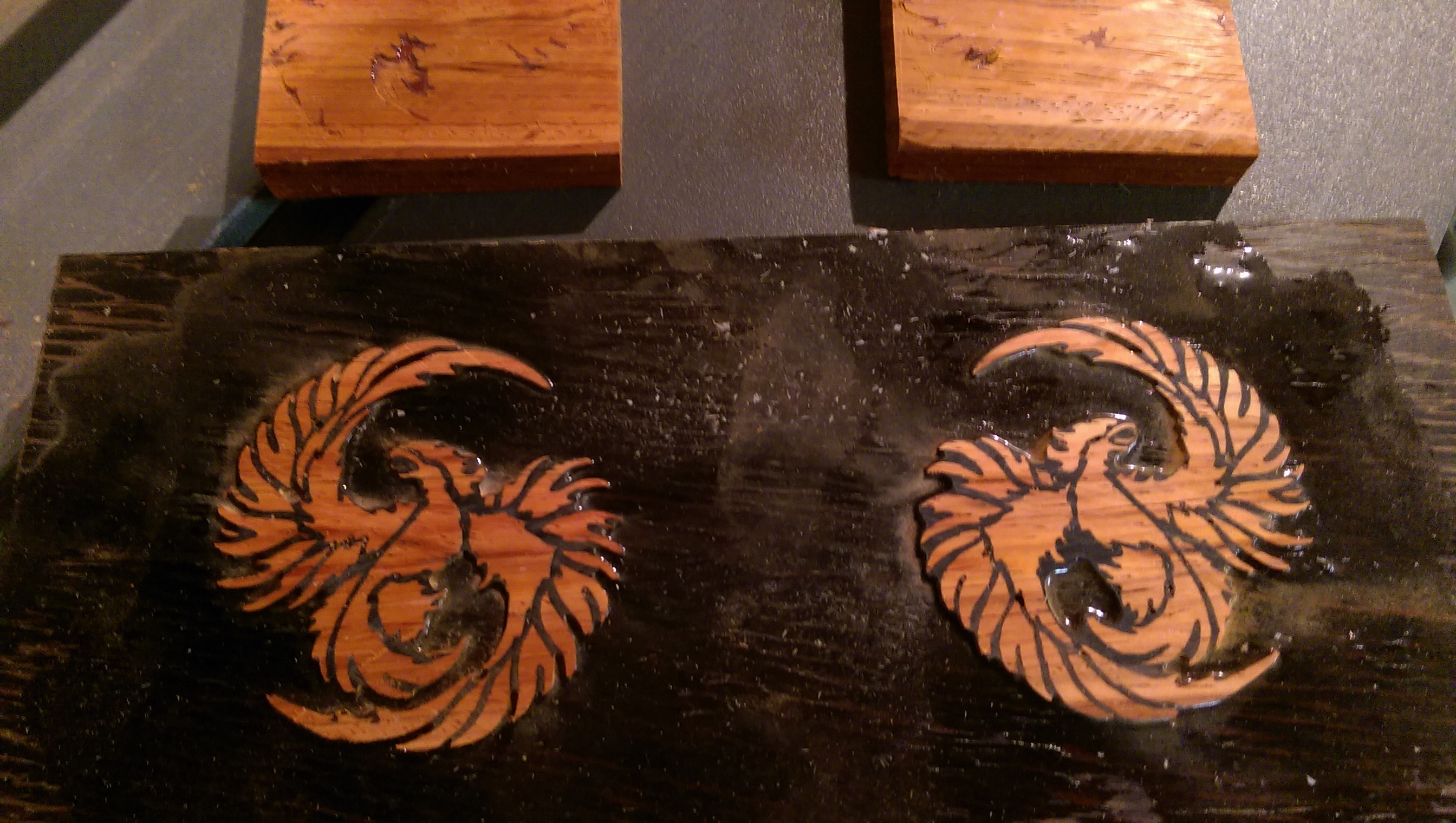

Yesterday I started on the first box. I ran in to some issues with the fine detail and a 90-degree bit, so I’ve ordered a 30-degree and 60-degree bits before tackling the next inlay. I filled the gap with west systems resin mixed with sawdust from the inlay, but I didn’t have enough dust mixed in to make the filler look like wood. I still think it looks decent for a first time v-carve inlay.
Material selection: Purpleheart for the base, yellowheart for the inlay.

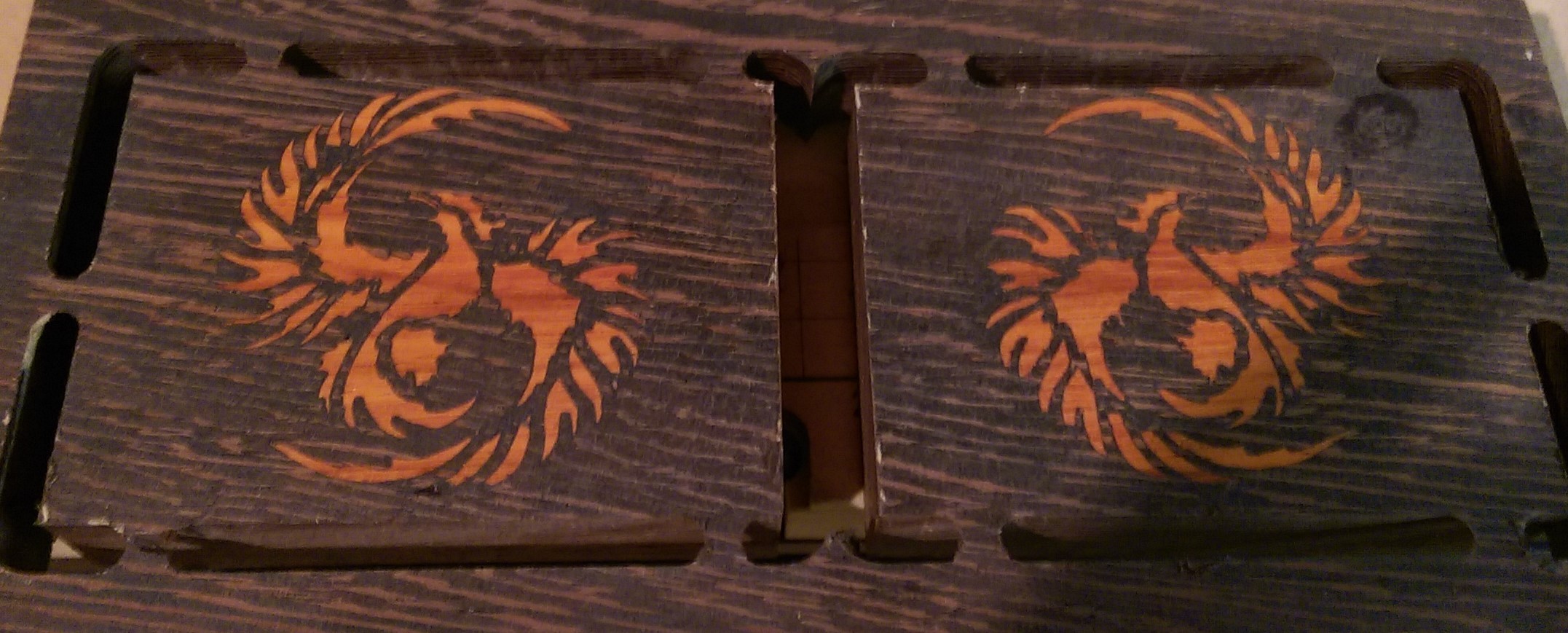

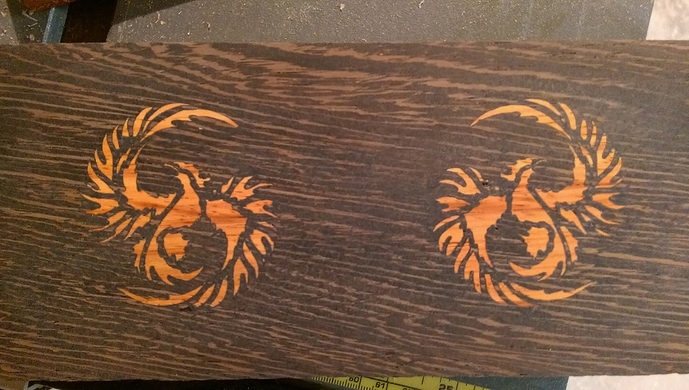

After the inlay was glued in place I separated the pieces on my tablesaw and sanded it flat. You can see the gaps and unfilled groves where the 90-degree bit just couldn’t maintain the detail. (Notice one of my kittens photobombing in the upper right…)
The cutout and subsequent sanding came out well, given that somehow my cutout path was missing tabs (!!!).
Unfortunately, due to the missing tabs I have some tear-out on the corners of each half that I am going to need to deal with… I’m not quite sure if I am going to try to patch this with some shavings or round off the edges. I allowed enough extra material in the thickness dimension that I can take off up to an extra .1 and still hit the minimum dimensions I need.
