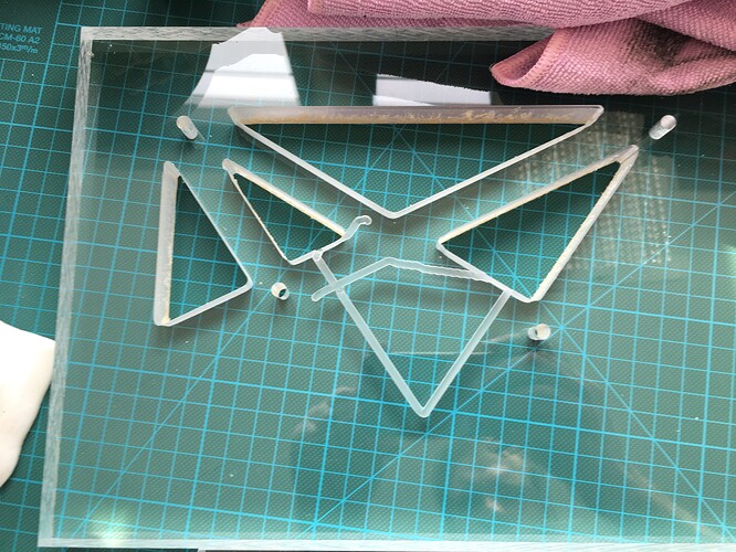

I’m trying to carve a logo out of 20mm acrylic that I previously cut out of 24mm cherry wood.
The wood carve worked flawless.
The acrylic carve however went quite wrong:
I tried using the same grey 1/8" upcut bit I used for the wood. It started out fine but then went off path and started to make pretty unhealthy sounds ![]()
It seems as if it lost track of it’s Y coordinate and tried to carve the bottom cutout too high up. Also the Z axis seemed too deep when I stopped the machine. It’s supposed to use 1mm depth per pass but there it was carving in more like 2-3mm depth.
When I touched the acrylic to take it out it was pretty hot even a couple of minutes after I stopped the machine. So I’m guessing the issue is heat and amount of dirt over time?

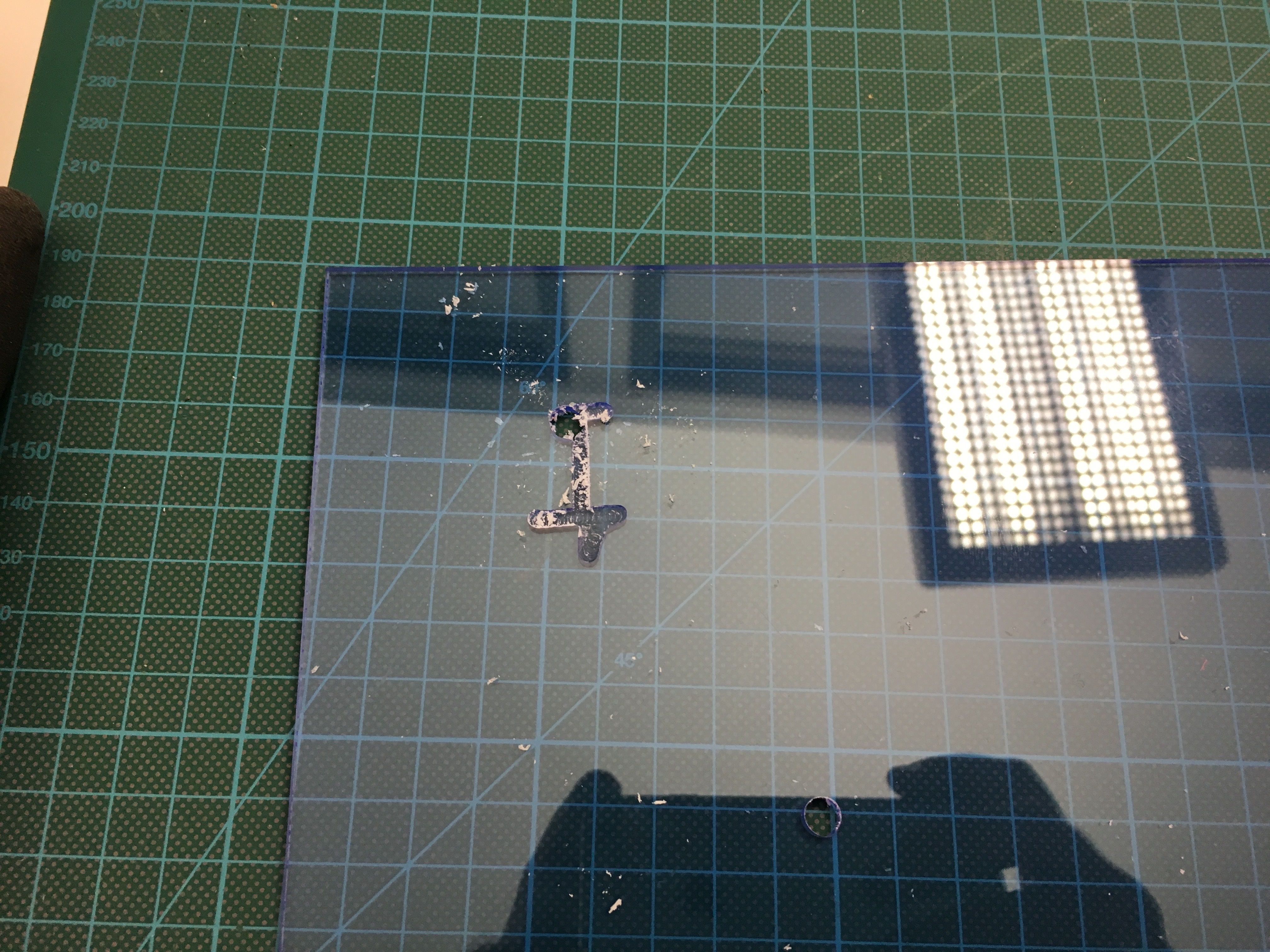

But then in a second cutout attempt it stopped/lost track at the very same place. During a 45 degree diagonal motion where both the X and Y coordinates are changing. It never seems to happen on straights where only the X or only the Y coordinates are changing.
I know 20mm acrylic is going to be tough, if at all possible. I also read you’re supposed to cool the bit with water. Which isn’t quite possible in the Carvey since it stops when I open the door. Though there’s probably a way around that.
Does anyone have experience cutting acrylic on the Carvey? Are my assumptions correct? Or is the issue something else?
I first searched the forums and read tips about tensioning the belts. I could try that, however I successfully did another wood carve of the same object after the acrylic failed, so am not sure the machine itself is the issue. More likely something I’m doing wrong here.
If heat is the issue maybe I could pause the cut more often and let the bit cool down.
