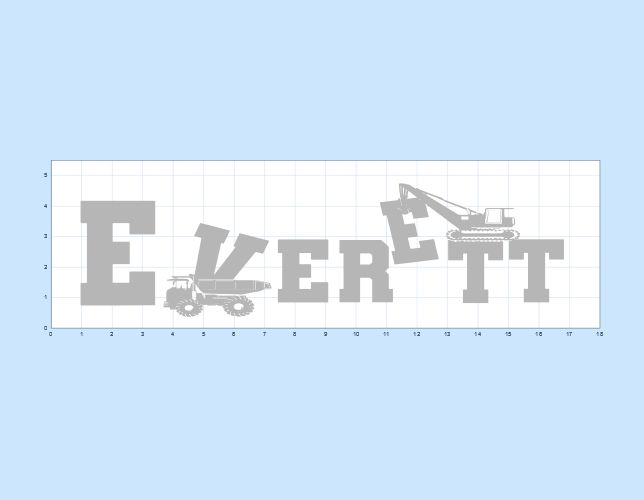

Can you share one of the files here so we can take a look and see if maybe it is something in it?
This is the first sign that took a week to get one decent.
This was the best one. It left grooves and didn’t Carve the detail on the truck body or from the crane into the letter E.
The file looks good. Looks like from the sign something is not right with the machine or you are loosing steps. What setting do you have the router set on?
I don’t see anything wrong with the second one.

@SheriKibbe The file looks fine. I would cut it only .1 deep but I see nothing wrong with the file. Then look at the machine. There is definitely something loose. It also appears that you need to tram the machine. It appears that the bit is cutting on a slight angle. Start with the v wheels and adjust to where you can just barely rotate by hand. Check the tension on the belts, I like about 3.5 lbs when pulled one inch.
