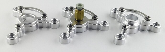

              The parts are all milled from Alco 5 tool plate at 1/4" thickness.  They are upgrade parts for the hot end mounting of a SeemeCNC Rostock Max or Orion 3D delta printer.
