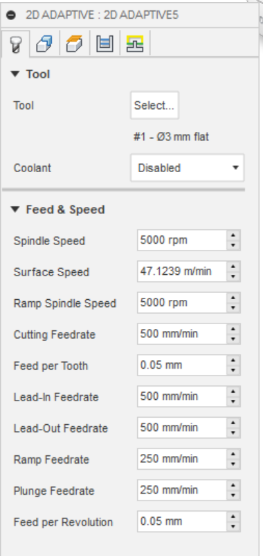

This says that Surface Speed for aluminium should be 45 M/M so my toolpath now looks like this (DOC = 2mm, adaptive toolpath)
5000RPM seems very slow to me.
Here is a chart I tend to use myself, my primary target here is feed per tooth
A 3mm tool => 0.025mm/tooth
With Dewalt at #1 (16k RPM)
16.000 * 0.025 * number of flutes => 400mm/min per flute of the tool.
I’d derate the target to 0.020 => 320mm/min per flute and take it from there.
As you can see, the Dewalt will not have the RPM neccesary to take SFM to the max therefore maintaining a target chip thickness is “better” to use.
You could also increase RPM, just maintaining the same chip thickness.
In Fusion set RPM and chip thickness and Fusion do the rest :slight_smile:
Thanks. I think I’ll go for this and see what happens
DOC = 2mm or less?
For slotting go easier and increase once a baseline is established.
For pockets use 2D Adaptive and try 2mm first, again increase as seen fit.
