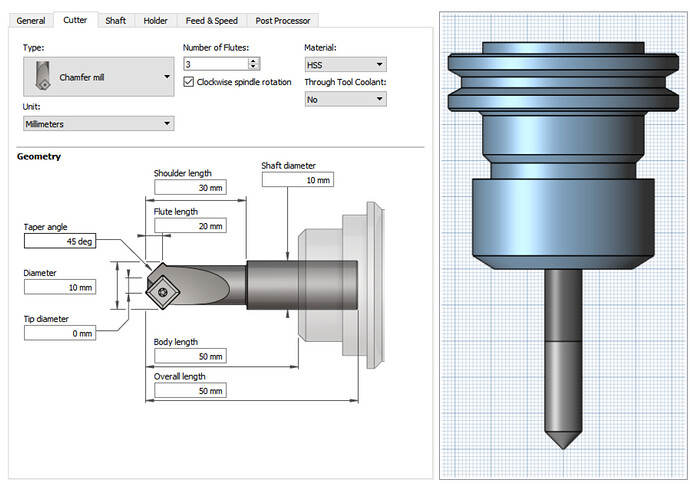

It seems to me I should create a Fusion 360 tool library containing the milling bits I actually have. So far I’ve got the 2 sample bits with my X-Carve plus the 1/8" 5 different piece milling sample pack from Inventables. Some of these bits have Onsrud part #'s and some don’t. So what’s the best way to create a Fusion 360 tool library with my bits? How do I determine the various feeds and speeds that are part of the Fusion parameters?
@StevePrior - you have a couple options. Easiest thing to do is create a new library and then create new tools within the library. I put all my tools in the cloud library should I ever need them to be accessible from the web when I’m not at my computer.

Thanks, I’m looking at it. I don’t understand why the tool library cares about modeling the holder/collet, as far as I can tell once you know the shank diameter you’d use whatever holder allowed that shank - can you explain?
For a machine like the x-carve, I don’t think it will ever matter and isn’t really a necessary step. A machine like a Tormach, if you model the holder and the bit length, when you install that bit, the machine can offset the z distance correctly when you tell it which tool number you are using. Then you can do tool changes without having to re-zero the z axis like you do with the x-carve after a bit change.

there is another reason to have the collet in there as well.
Fusion 360 can calculate collisions, which would be bad
so It could give som more space if you model the collet.
The effort of adding the collet was very limited after understanding what goes where.
Ofcourse you can make your own script afterwards or just hndle it manualy.
Look for the toolchanges(M6) and add a pause and a tool z offset and you can work with different tools in one g-code file

Could you please be so kind as to possibly post a video of how to set up a collet for the tool holder? It seems as though not only I, by a “myriad” (my word of the week) of people are hitting a wall on this one, as Autodesk, does not seem to want to provide much direction to us router users.
