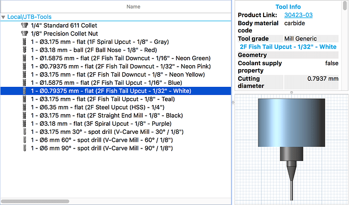

Fusion360 Tool Library for all Inventables Bit Sets
Hi - I have a library containing the following bit sets here:
• Carving Bit Starter Set
• Carving Bit Super Pack
• Fine Detail & Engraving Set
• Wood & Plastic Set
• Soft Metal Set
• 1/8" V-Carving Set
• HSS 2F Upcut 1/4" Bit
Here’s a list of the individual bits (since there’s a lot of overlap in the sets):
• 1F Spiral Upcut - 1/8" - Gray [30238-02]
• 2F Ball Nose - 1/8" - Red [30240-02]
• 2F Fish Tail Downcut - 1/16" - Neon Green [30667-02]
• 2F Fish Tail Downcut - 1/32" - Neon Pink [30667-01]
• 2F Fish Tail Downcut - 1/8" - Neon Yellow [30667-03]
• 2F Fish Tail Upcut - 1/32" - White [30423-03]
• 2F Fish Tail Upcut - 1/16" - Blue [30423-01]
• 2F Fish Tail Upcut - 1/8" - Teal [30423-07]
• 2F Steel (HSS) Spiral Upcut - 1/4" [26006-01]
• 2F Straight End Mill - 1/8" - Black [30237-02]
• 3F Spiral Upcut - 1/8" - Purple [30669-01]
• V-Carve 30° - 1/8" Shank - Orange [30499-01]
• V-Carve 60° - 1/8" Shank - Blue [30342-04]
• V-Carve 90° - 1/8" Shank - Tan [30342-03]
The toolset also includes the Precision 1/8" Collet and the standard DeWalt 611 1/4" collet that comes with the spindle.
If you have a different collet, make sure you just take the height and diameter measurements and input them into a new holder in the program - this will prevent any collisions (though Inventables has made it fairly foolproof by including set collars on all their bits - these are taken into account on the shaft specifications so you will have your tool lengths matched in reality and the program every time).
If you are unsure which bit is which, the product links and item numbers are included in the tool info!
Here’s the file: x-carve-tools-ver-3.tools (3.6 KB)

Make sure to check your own feeds and speeds before cutting. They are currently set to some reasonable defaults (between 1000 - 1200 mm/min for 1/16 & 1/8 bits), and all using 16000 RPMs (#1 on DeWalt 611).
I believe I selected all the available options for bits apart from maybe one or two during the order process, so a lot of people should find this useful to get programming their CAM stuff in F360 quickly. I hope someone else finds this useful!

Tool Library:
Then Control + Click / Right Click your Local Library and Import:
Just be sure to set your own feeds and speeds. I’ve set the feedrates reasonably so they can be used as a starting point for MDF, but you may want to drop down even more with the 1/32" bits since I don’t have much experience with them on anything other than extremely light material. Every one of the tools has a 16000 RPM set already, which is the #1 on the DeWalt 611.

I’m just now getting into Fusion360 and there seems to be some unit weirdness when I import this file. The Library screen which shows all the tools in a list shows inches (which I want), however, when I go to edit a specific tool, it’s all metric. How do I set up Fusion360 to show inches all around?
Replying to myself. This was my bad. I didn’t realize there’s a drop down in the properties of each tool for units. I’ll simply switch them all to inches and save.
