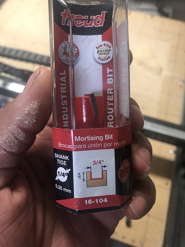

So I can place a second board on top of my spoil board, then perform a skim cut to make that board even. Then if there is anything wrong it would be in the wood I’m using. I only have a 60 and 90 degree bit would that work. Where will I have the way to increase the stepover
Under machine advanced. The default is 40%. That works fine. I use a 3/4 flat bit
Ok sorry for all the questions. Is there a size the second board should be. I have 3/4 in plywood that is flat and square
That will work
As long as its bigger than the part that is getting carved.
Carve time for skim cut will decrease with larger stepover percentage, I also use a 3/4"flat bit.

so I went out and got this bit to do the skim on my second board.
That is the same bit that I use
