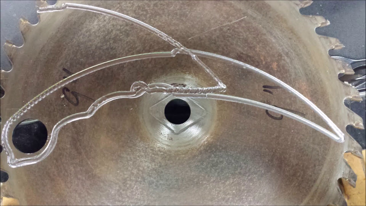

Well we all know this is not a perfect world so I decided to put this here as a reminder that no matter how long you have been doing this sometimes things go south. I was all in fun for testing and it can be done. more bits on the way. I was impressed with the depth of cut as things went off path a 4 flute is now a 2 flute to the carbide scrap bin you go (saying little prayer).
This all went south because of laziness on my part if I had walked around the table instead of reaching over catching my coat sleeve on the z axis this might have been a nice little project vid.

are you trying to make a knife blade?

I make knives from saw blades, mower blades and other hard metals. currently around 30 of them have been made on the xcarve. But the current round of test are for a process that larger machines use to make more efficient use of a cutting tool by using 14,000- 30,000 rpm spindle speeds by use of a over drive mechanism attached to the spindle running 300-800ipm taking very light passes keeping the load on tooling very low and not requiring coolant. I am just adapting the methods to work with the xcarve because it fits the requirements the machine can provide. And other than this fail it is working very well.
