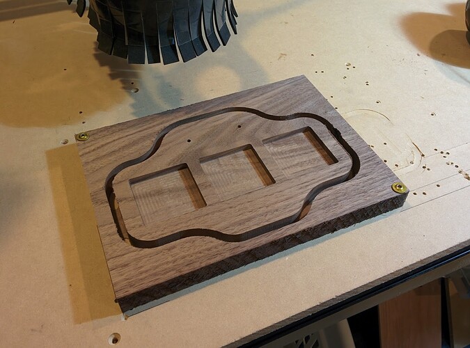

So my buddy asked me to make some plaques for him to give as Christmas presents. I figured it was a good opportunity to push myself to learn more, faster. I did the 611 upgrade, and I spent the money on V-Carve Desktop, spent some time learning it, ran a bunch of test cuts, worked up the design for him, and have generally been happy with the results so far. He wants red oak, and I’ve struggled with finding the right settings to get a clean cut with the red oak. Last night I was confident enough to pull the trigger. Final plaque size is about 11 x 17. I started with rough-sawn 5/4 x 13 red oak. I ripped it down to 12" wide so it would fit through my planer, and I planed it down to 3/4. I ran my v-carve toolpaths, followed by my profile toolpath using a 1/4" 2-flute upcut bit to cut the piece out, with tabs. I set it to do a finishing pass of .05, and reverse direction on the final pass, as I understood this would provide a better surface finish. But once it turned around to do the very last pass, it didn’t make it more than about 2 inches before it started chattering, and another inch or 2 before it took a detour… disheartening! It dug in and pulled itself right into the workpiece. It shook so bad that a bunch of screws came loose on the machine. Time to start over… ugh!

I’ve been using climb milling with no problem what so ever. Actually in all of your pictures you posted there’s climb milling, even if you choose conventional milling for your contours, you’re still climb milling the outer edge.
And you’ll notice that the surface finish on that is absolute crap, all chattered and nasty. Then look at the inside face that was conventionally cut with the finish pass. Just no comparison in quality. You can see that particularly in the top of the part, where the inside surface is generally visible. I’ve just had no luck with climb cutting at all, I get tons of jerky motion and excessive chatter. Your mileage may be entirely different, of course, given your setup. I suspect that if I stiffened mine a bit more, I could get away with it.

I actually went back and looked at my toolpaths and i was climb milling the whole time. It was when it switched to conventional for the final pass that it took a bite out of the workpiece. Getting ready to give it another go, but this time I’ll just not reverse the finishing path. Fingers crossed.
OK, ran it again tonight, and once again it took a shit on me. I changed the outside cut to conventional, an NOT reversing the finishing pass. Got down to nearly the last pass and it started chattering and took a left turn on me again. I caught it quicker tonight, so it doesn’t look as bad, but it’s too much damage to salvage.
Reduce depth of cut by 50% or more. For red Oak I have been using .018 and it seems to prevent this. It is just my opinion but its the bit, not the machine. Make sure its sharp and cut very shallow passes. Good luck!
@DonDespain, thanks for the input. The bit is brand new and has only been used these two times, so I assume it is sufficiently sharp. I will try reducing the depth of cut tonight. Do you use an upcut, downcut, or straight when making a cut like this?

This kind of failure really loads up the machine. I find that adjusting all the v-wheels and squaring up the rails is usually necessary to avoid a repeat performance.
I also found that cutters with straight flutes are more likely to catch an edge and pull off track, in a deep cut with vertical side like this. I really like single tooth cutters when milling wood.

This is good advice to be sure. After the first failure, things loosened up dramatically, to the point that the spindle mount wobbled around like crazy on the z. So I tightened everything and squared it all up. Ran test cuts and checked my dimensions and everything was good on all 3 axes. I will have to check it all again tonight before I start my next attempt.
Just have to be careful you don’t take it the OTHER way too far either. That slow and shallow seems like a bit of a recipe for burning and dull cutters, the chipload there is just REALLY light.
