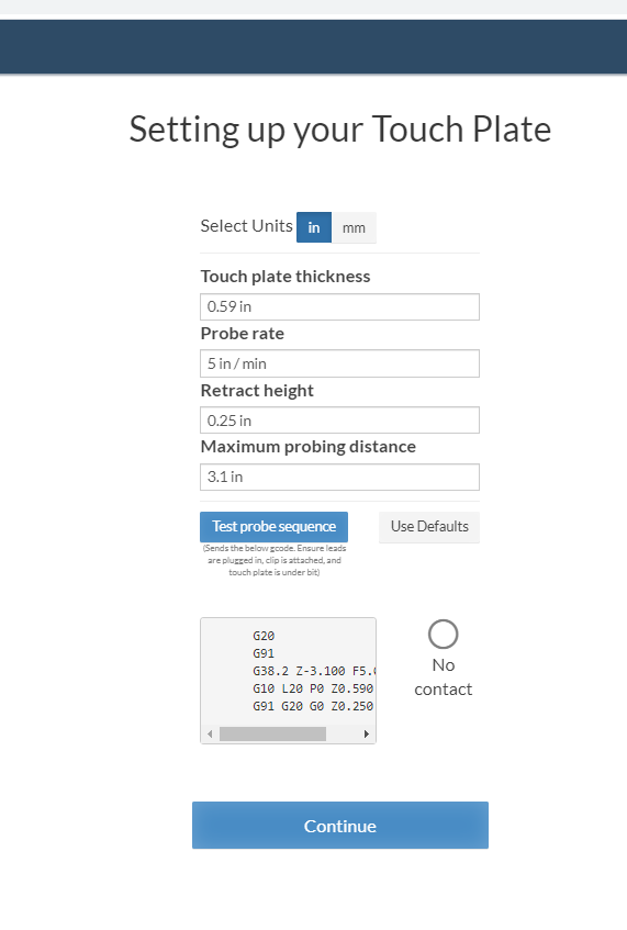

Anyone know where you edit the thickness of the z-probe puck now? I can’t find any settings other than turning z-probe on and off.
You should be able to go the the “Machine” menu option and go back through the machine setup process.

It looks like when you go though the setup, you go into advanced settings where you can change the height measurement.

@DebbieLee Go to the full Machine Setup and when the steps guide through the connectivity test there is an “Advanced Settings” a little grey button, kind of hidden just above the blue next button, click that and you get the option to configure the size and other operational parameters

Please make editing the puck thickness easier. Crazy that you have yo uninstall your machine to edit. Mine cuts far too deep despite recording the exact puck depth; it cuts about 1.5 mm deeper…any suggestions welcome

Then there’s the fact that Easel stores the puck thickness in a place that is rather easy to have erased and set to the 14.99mm default by mistake, Ive found no less than 5 ways to inadvertently cause easel to “forget” the custom probe thickness and the user will be none the wiser until they ruin a couple projects.
Please tell me more
I don’t really know what you want more info about. . . like how I made easel forget my probe thickenss through various methods??
Well if you have more than one machine profile (even if you set them both to the right thickness) the moment you switch profiles any custom thickness settings are lost forever.
If you go into “edit machine” and uncheck Z probe and then click “save” the custom thickness is lost forever, so if you go back in an turn it on . . .well now you’re using a 14.99mm probe
If you clear your browser cache (like a decent sized browser or Windows update will) then your probe thickness is reset to 14.99mm (same thing if certain antivirus clears it)

THAT, Seth, is very helpful. I had to clear the cache to get into Easel last time as it was locked up. I think that is why/how the z probe was reset. Although 14.99 is a lot different to 19.1 and it is only cutting 1.5/2mm too deep but only when using the probe. Old fashioned fag (cigarette this side of the pond) paper method cuts correctly.
I still would like to see a simpler method of resetting the probe puck height without having to go through the rigmarole of uninstalling and reinstalling the machine. A backward step sadly…
