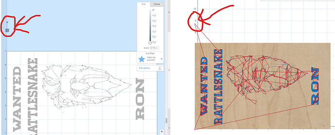

I have been experiencing problems with lines of text carving misaligned I center my words on the work piece but when it carves the second line of text is misa;ligned also when it carves it carves a lot deeper than what I set it for and when you stop the carve because of misaligned text it does not return to the original home spot set when beginning carve I have uninstalled easel and reinstalled on another computor same results I am using a sainsmart 3018 any help is apprecciated Dennis Mariner7018@gmail.com I have made many plaques and this is the first one text has done this

Post your project, Easel - File - Share - Share publicly, copy URL and click Save, post URL here.

You have some extra geometry off your workpiece. (Right near X0 beyond your workpiece on the Y)
The machine tried to go further in the Y than it can handle. You crashed and it lost position.
When designing I have a “best practice” were I select all to be sure I don’t have any stray elements in my projects. HAs helped me a couple of times eliminate issues.
Absolutely good advice.
CTRL+A = Select all
Good catch ![]()
