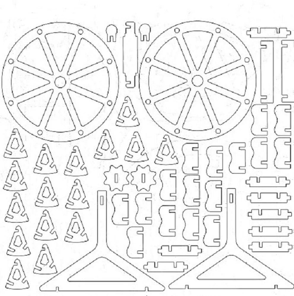

I’m trying to import a JPG design that I have scanned on my computer into easel that has cutouts in it that looks great from the scan and the file on computer but when I import the image it gets all destorted. The shapes aren’t as they are supposed to be. Instead the cutouts for the locking peices being square they are rounded. Anyone have any idea what’s going on here and is there any solution to this problem?

This is the scanned object from computer. Not the best but I hope someone can help me with this
I think the easiest thing I would do is redraw the parts, as many of them are multiples of the same thing.
Hi Larry, thanks for posting this up.
Please don’t be offended by anything that I say. I’m not trying to be mean, it is just simple criticism. Your image appears to have been scanned in grayscale, or perhaps color - there is a lot of artifacting that will interfere with trying to convert the file. Try scanning it at at least 150dpi and black & white. That should help clean it up a bit.
I did try importing the jpg as is using the Image Trace app in Easel with smoothing at 0, and a threshold around 72 got me the best results, but I can definitely see the rounding that you are talking about, and that just won’t do. I find Image Trace to be pretty disappointing most of the time, and your project doesn’t trace nicely either.
I edited your jpg in PhotoShop, although there are many graphic programs out there than can do the same thing or better. For example, CorelDraw might do a better job. I first converted the file to black & white (it does still keep a lot of artifacting), and did a Sharpen Edges filter on it a couple of times. I output as a jpg image, and then using convertio.co to convert from the jpg to an SVG (under CAD), and import that SVG into Easel. It is better, but still a lot of junk to clean up.

I don’t know if this will help you or not. @MartinW.Mcclary has a good suggestion in redrawing each individual shape to the dimensions that you want, and then copy and paste for how many you need. You can possibly use the file I have created to get you started on doing just that.
I would definitely be curious to see if doing another scan in black & white at 150dpi or higher would yeild a better result. If you could do that, I could try again?
