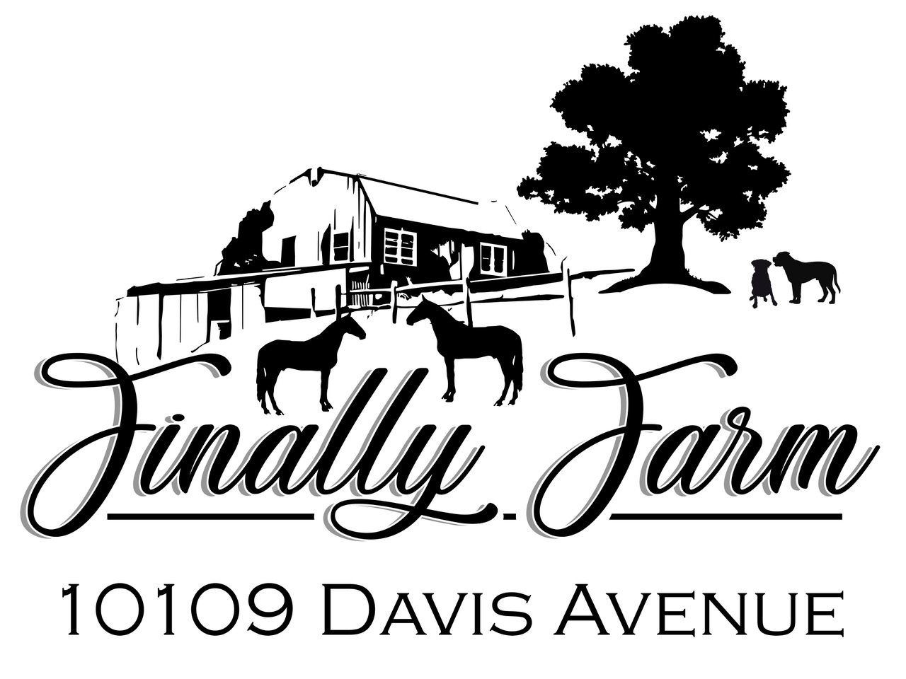

Looking for some help in trying to get an image to upload. I have it saved as JPG and tried resaving as PNG but both ways lose all detail when I upload it.Thanks for any help!
Easel Image app dont handle intricate designs well when you want the scan to stay true to the source. Using Inkscape to create a black and white SVG is for such tasks much better, also if you want to tidy up the design before saving as SVG ![]()
Video reference - https://www.youtube.com/watch?v=n1fqbBiHAug
Quick bitmap trace in Inkscape and saved as SVG, then imported to Easel.
No tidiying up of the design have been done.
Thank you so much!
