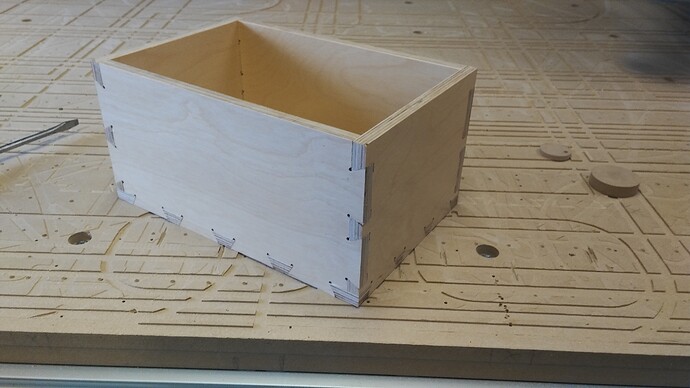

Hey everyone I wanted to share a dovetail box that I was working on I am getting into cutting drawers for cabinets I would like feedback on how you think it would work out for that purpose

yeah I dont like them either and yeah the only way to ge rid of them when milling on the face is to round the edges of the male dovetail pins
but the way I did that with 1 tool a 1/8" compression they are required
and yeah lol that box is extremely tight fit rubber mallet is required to put it together
thats how I created the dovetail box is the gadget in v-carve pro
I will have to mess with it and see if I can add a fillet to the pins and slots which would make a rounded dovetail and thus no dogbone deals
and no there are other solutions out there for flat cutting on the cnc but are you meaning with 100% square corners or will rounded dovetails work?
top job, if its hammer tight then its awesome and once its glued up, more so,
. more pics as the job goes on please, very interested in this dovetail cnc thing,
Awesome! Not too tight or you’ll glue starve the joint. Make dry-fit problematic. Should be able to wiggle in and out. Also, make sure the dovetail is in the correct orientation/direction to oppose the tensile forces of the drawer slamming shut a million times. Soft-close slides help too.
well really as sturdy as this box is you really dont even need to use glue

I notice that the v-carve gadget does not allow you put any clearence in the joints when it generates the gcode

Getting rid of the dogbones:
To do it with 3D carving: Cut the entire project using an 1/8 ballnose endmill. You’ll be left with a small radius in each inside corner - which is easily removed by quickly cleaning it up with a chisel.
To do it with 2D carving, you have to have a vertical setup. You can cut both tails and pins separately with a flat endmill, or cut both at the same time with a dovetail bit.
Alternatively, you can make miter joints and then strengthen them by adding splines. Very attractive and really easy to do.
This box was done using 3d toolpaths using a flat end mill at a 30 degree angle
I am not 2 sure that a chisel would work on the plywood as it would just chip out right and well the time it would take to do all of that on each panel being cut

About your current project: You shouldn’t have to angle your end mill or tilt your piece if your including dog bones.If you’re already using 3D toolpaths, just switch to ball nose and cut the whole piece out at 90°.
Miter splines are simply a 45° miter joint with slots cut into the corners to accept spline reinforcements. The reason they do this is because endgrain to endgrain glueups are not particularly strong or have much surface area. By addind in long grain splines you strength the joint significantly.
They can be any shape you want, including dovetail. Which could give you a smiliar look to handcut/through dovetails. There are a lot of really great table saw jigs and hand tool tutorials on youtube for making them. If you set up a table saw jig, it literally only takes a couple minutes.
