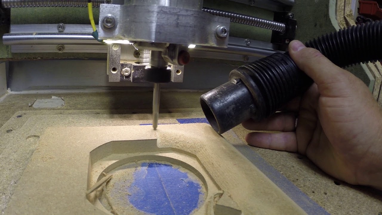

Dennis, the video linked below contains an example where I used MeshCAM (paid CAM program) to generate the 3D toolpaths to machine my desired clamp (its front slope makes it a 3D job) and then imported the GCode for each toolpath into Easel to run the job.
(274) CNC Machining a Wooden Clamp using MeshCAM V8 - YouTube
I use Fusion360 for the CAD&CAM, then use Easel (or UGS) to transmit the code to the machine.
