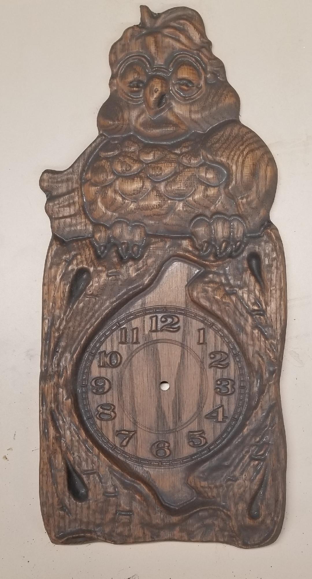

Certainly, the X-Carve can carve 3d reliefs, but you would need a 3rd software to generate the toolpaths into 3d toolpaths and then import the gcode to use easel as a sender only.
IF you’d like to try one of those 3rd party software options, I have a tutorial and a 90 day free download to try out Carveco Maker (normally $15/month) … but Fusion360, and Vcarve Pro are other common softwares used for 3d carving on many cnc machines including the X-Carve.
