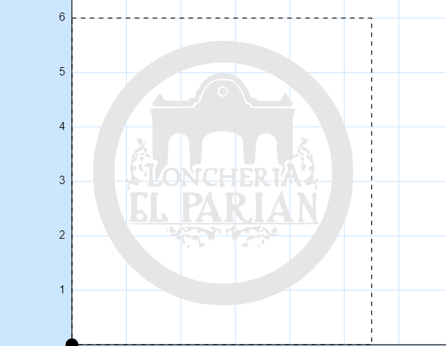

can anyone help me to get my x carve working correctly I finaly got it up and running but for some reason its only making little squares I have tried everything that I could think of I olso tried getting tech supprt on the phone but still no call back has this ever happened to anyone else before?
Using easel? Pictures? Need some additional information
yes im using easel!!46216114_733216023678429_453732070410158080_n
what is your pattern?
in Easel
Click File - then share
then copy the share URL and paste it here.
Thanks
Martin
http://easel.inventables.com/projects/KRe3pAiqwU2f6Vh3Jd8RCQ
Check your wiring. It almost looks like you have your Z and X axes swapped.
Would my x control turn on even if the wires were wrong inside of it? Because outside everything looks right. I took my time and made sure to put it together like the instructions said.

Done! Thank you you were right! I really appreciate your help
