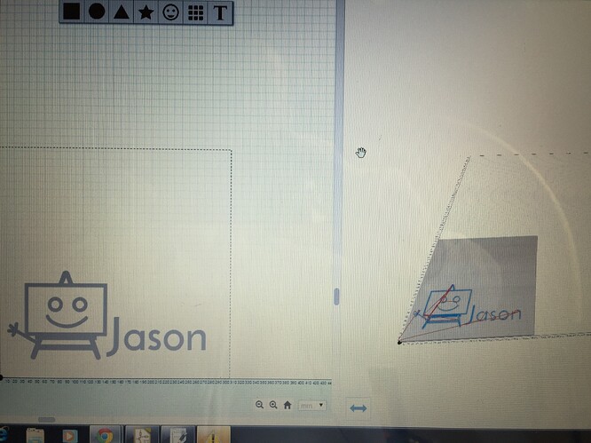

I have finished my x-carve and cut out the Intro to Easel project and it came out in a mirror image of what was on the screen. Also it is cutting 90° from the front of the machine. I’m not sure what’s going on. If anyone has any ideas it would be greatly appreciated.
That’s CRAZY! Have you checked all you wiring? Maybe your X and Y are swapped as well as the polarity?

Did you run through the Easel setup process and confirm the motors were moving in the correct direction?

Ok, that’s totally what it was. My x and y where backwards. I did go through the setup of the machine but it never dawned on my that they were wrong. I was just happy that they moved. I think part of the problem was the computer was 90° to the x-carve.

I think you go too fast on Machine Setup on Easel. Make sure those arrow keys are moving all axis on right direction.
