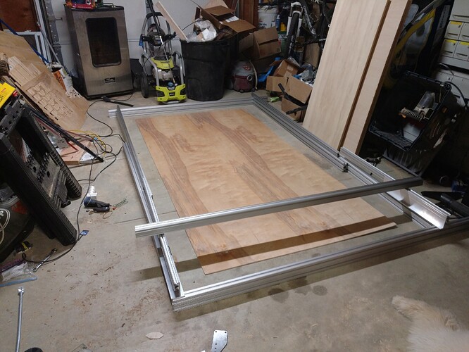

We appear to be at similar crossroads of our lives … Attached image of my test fit yesterday, waiting for one more box to come from 80 20 tomorrow.
That is going to be an incredibly solid surface…nice job Angus! Now hurry up and get to making some stuff
Looking good! I want to put a longer cord on my Makita to do exactly what you are, where did you find the extra cord? What is the specification on it?
I’m also interested on the longer cord - and I’m using the DW611 as well. Once i finish my table build for the CNC i’ll be rewiring the carcass anyways so figured I’d hit the router with a better cable too
Awesome thanks for the info!

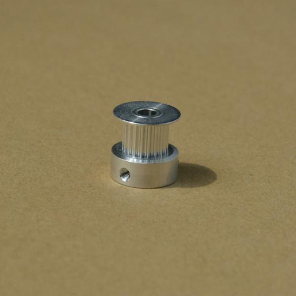

Mind sharing where you got that belt from? been considering going 9mm for my large build but its a jungle out there once you look beyond 6mm.
Angus,
What place in HK did you get the pulley from?
I do see the belt at the SDP/SI website for $6.44.
Catalog | Designatronics Store | Stock Drive Products/Sterling Instrument A26R51M080090
Thanks!
Angus: go to eBay.com and type in: " 20T 8mm Bore 9/10mm Width GT2 Timing Belt Alu Drive Pulley For DIY 3D Printer"
This should get you the info you want for the pulley!
Martin: I guess I should have sent my reply remark to you

Quick edit. I was looking at Robotdigg and noticed that they too have the 20 tooth, 9mm wide, 8mm bore pulleys. It looks like choice selection is for 5mm/6.35mm/8mm bores.
Left side with one corner on each side. Also you are not planning to use all 4 holes?
I see that now, 80/20 for 15 series I ordered take 4 bolts.
https://8020.net/shop/4336.html
